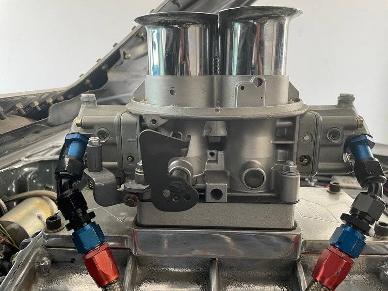

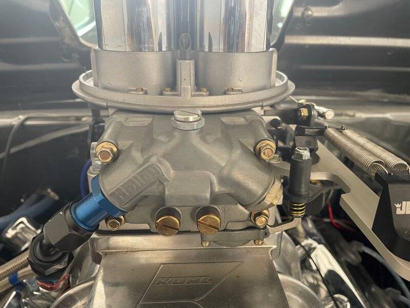

I have a 68 GTX. Original 440, 4 speed, Dana 60. Now has a blown 68 426 Hemi with stage V heads and 6-71 Weiand blower. I was told this carb was a Dominator 1050cfm. Only 30 miles on engine in last 31 years, so no real good test drives. My problem is that it will not idle. It constantly revs up and comes back down. No vacuum leaks found. Previous owner said it did that on the 440 before being swapped, which leads me to believe its the carb itself. He said the carb was sent to BDS to be compatible with this engine combo, so no telling what they did to it. I am not a carb guy, other than tweaking a smaller Edelbrock carb. I want this to be more streetable as a cruiser if possible. Should I go with a Holley EFI? Try a different carb? Thanks

Im no carb guru, but there are several here and fabo. But as i understand it, a blown power valve won't have an effect on idle. Its easily checked. Pull a bowl off, take the power valve (or valves, but i doubt there is a pv on the secondary side) and test it. Or, you could simply plug it, and fatten the jetting up four steps. You would have to ask someone else here about the wisdom of a power valve on a blown motor.

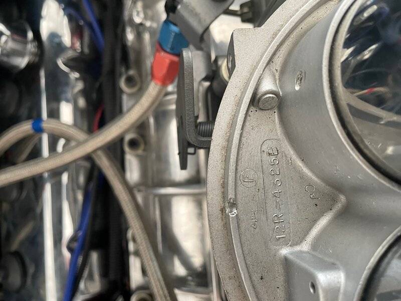

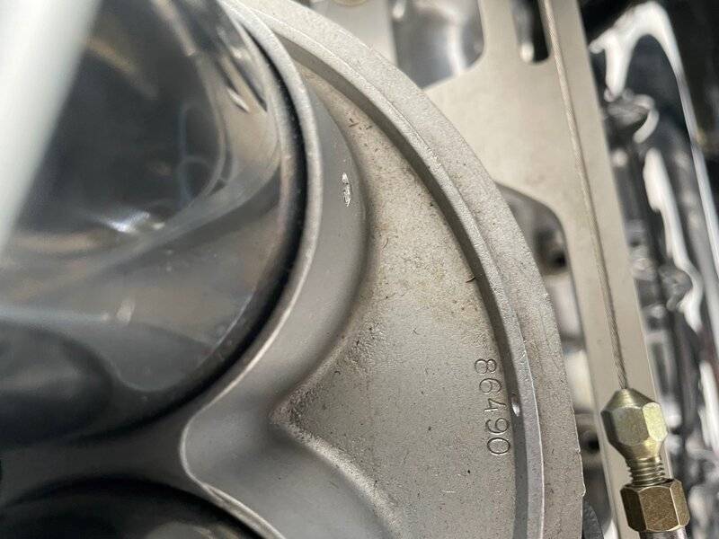

I dont think either number in the pics in post #1 identify the carb. Look for a "list" then a four digit number, or just L xxxx. Though your carb has been messed with. It looks very early because of the raised area above the throats, (might have had a choke) but the bowls and metering blocks are much newer. Has a secondary idle mix adjustment too.
Can not find a list number anywhere. That is all the numbers around the horn. I have no clue how to adjust anything on this carb except throttle screw!
