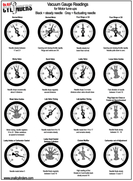

a very simple test is hook up a vacuum gauge and see what is going on. Second item the reluctor on the slid state might be bad they make one that stops the wander for 20.00 from mancini.

This is from “on all cylinders”.com
by Summit. The picture doesn’t look clear when enlarged so go to the site.
https://www.onallcylinders.com/2016/03/31/vac-visual-quick-guide-vacuum-gauge-readings/
