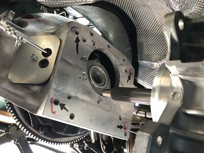

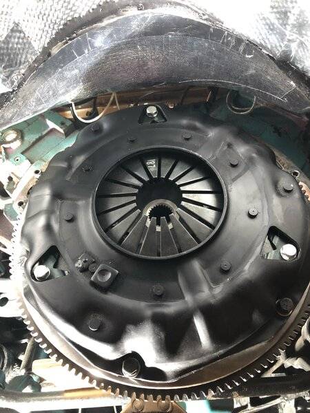

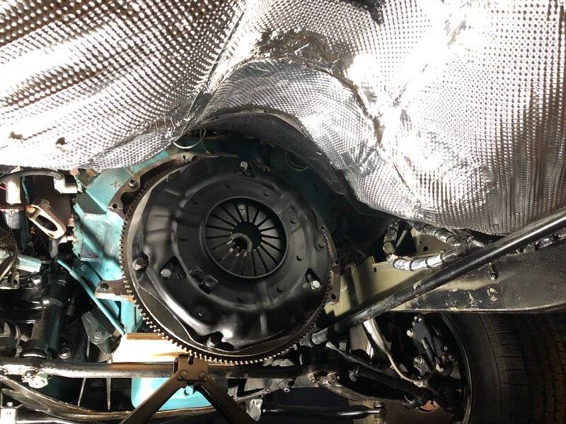

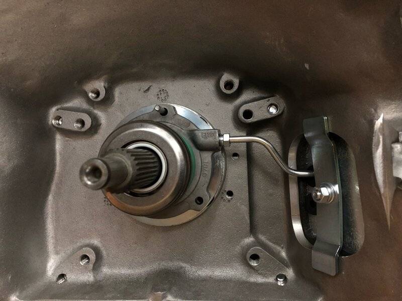

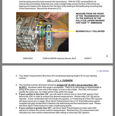

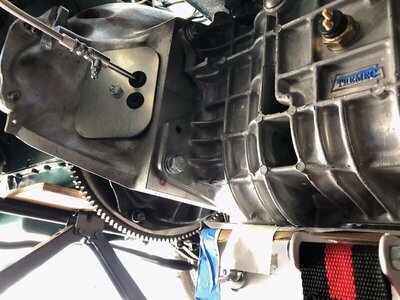

mounted up clutch, clutch cover, and did a hydraulic bearing measurement/install per the instructions. so far so good.
watermelon
AB561038-1E55-478B-B100-D3D459F54FD9.jpeg 779BAE49-5CDB-4985-AC49-638F4D466AFD.jpeg 69E03220-EA5C-4858-B2A7-DF7A785B84A6.jpeg 49296BA2-6D03-455D-BA06-F53B22EE531A.jpeg

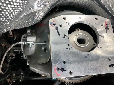

bellhousing bolted and hydraulic bearing in. connected up transmission. was curious to see how it was going to slide in with that bearing dangling there but it lined up and with a little patience and finesse slide right in.

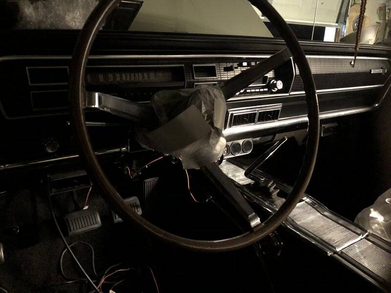

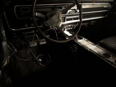

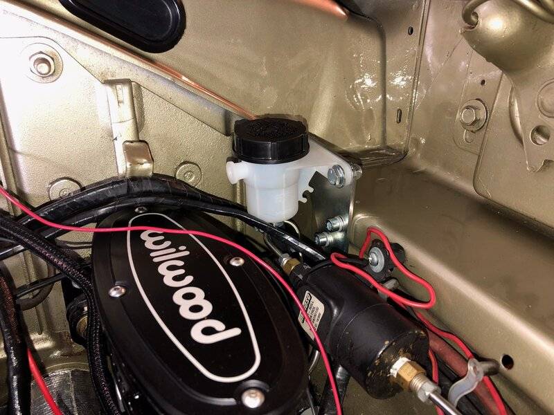

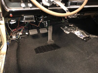

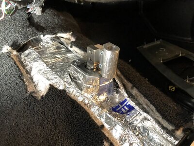

got an extra pedal in the car now. onto bleeding the hydraulic master cylinder for the clutch pedal.

I must ask, where did you get the heat insulation on the undercarriage?
the dimpled stuff is:
https://www.summitracing.com/parts/dei-050503
i did a light wash on the undercoat with warm water n soap and let dry for a few weeks while I did other things. then did a light coat of 3M high temp spray adhesive on the areas and applied the material. on the edges of material I applied 3M seam sealer. let everything dry then applied aluminum tape over seams. — the material itself has an adhesive backing
that in conjunction with my two layers of interior sound deadening/heat lining should be good
my goal has always been to make this thing as tight/comfortable as my Dodge Caravan. i am almost there.

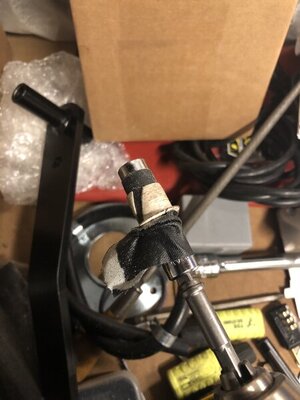

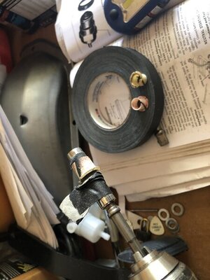

i missed posting this step. i had to mill down a little material on these plastic bushings to get the pin to slide in across the new clutch and brake pedal holes.
took a drill and some rough grit then some smooth grit to get it to comply. those who know know.

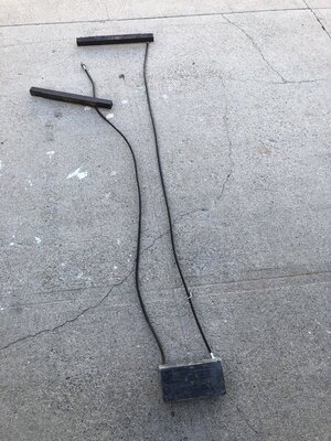

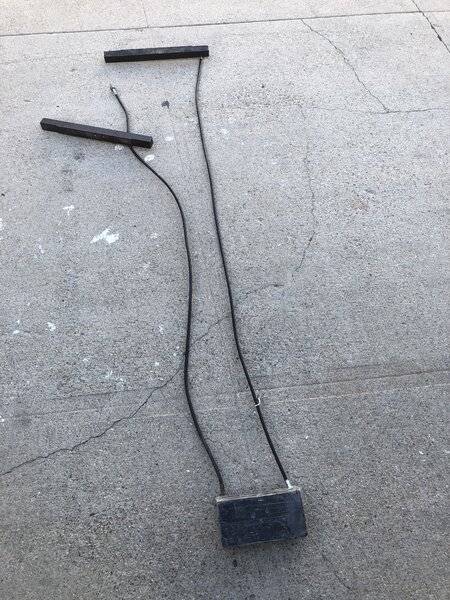

original speedo versus new SST speedo cable on the right...not too far off. about a coonhound’s length or about five-six buff *** chihuahua’s. you do the math.
gonna use the gps thing anyhow.

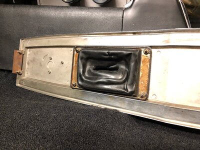

ordered a new rubber boot for the manual shift plate. was planning on running with the tattered one

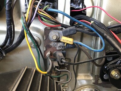

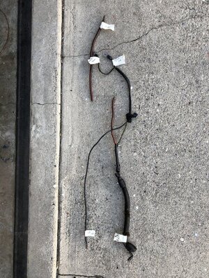

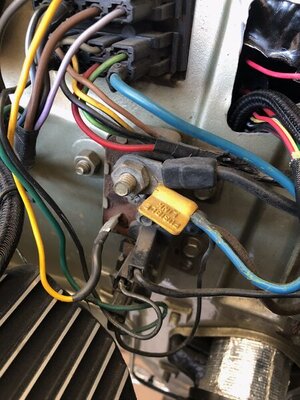

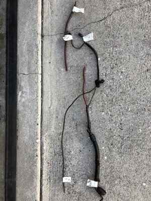

cutout the og starter wiring. wiring up some fresh stuff

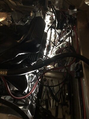

nothing to post other than have been fixing up a rats nest of wiring
does anyone know if i need to change the starter relay when going from auto to manual?
my thought is that i can ground the connection that used to go between the relay and the neutral safety switch on the 727. would that work?
any feedback is appreciated.
watermelon
got some advice over on the electrical forum here. going to run this car without the NSS.

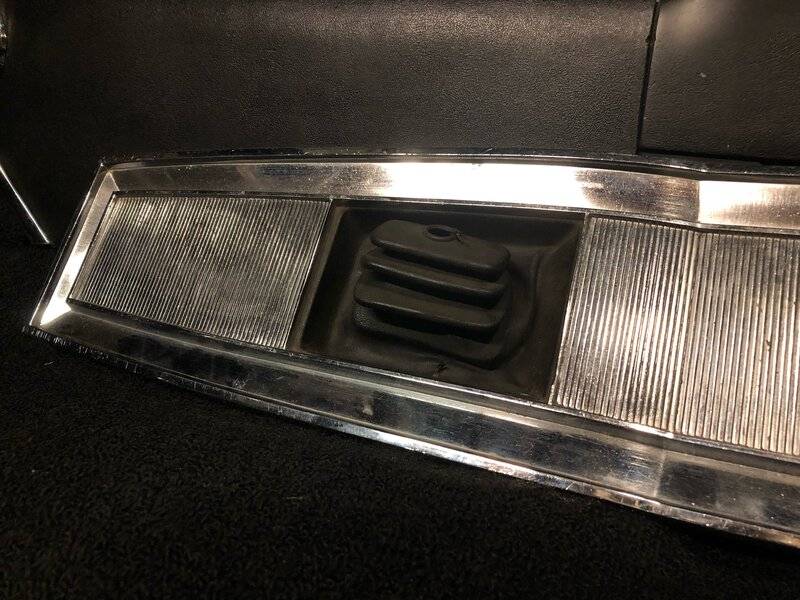

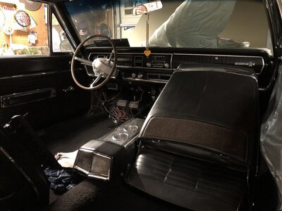

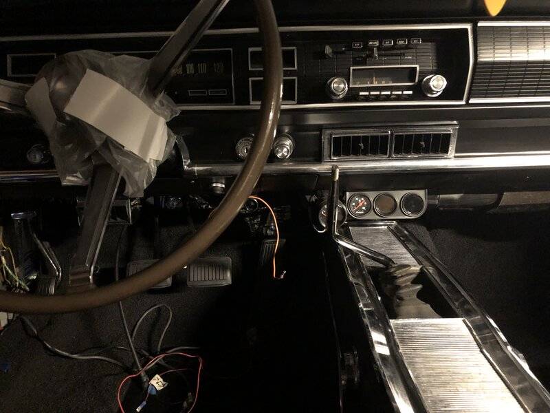

moved onto fitting up a center console that lived its life with a 727. it will have to get used to a tko500 shifter.
and a random shot of wiring rats nest...cleaning this up might take longer than the tko500 install
ohh...did i mention i started this project last September......damn....September is coming quick. no fault of any vendor...just life giving me priorities.

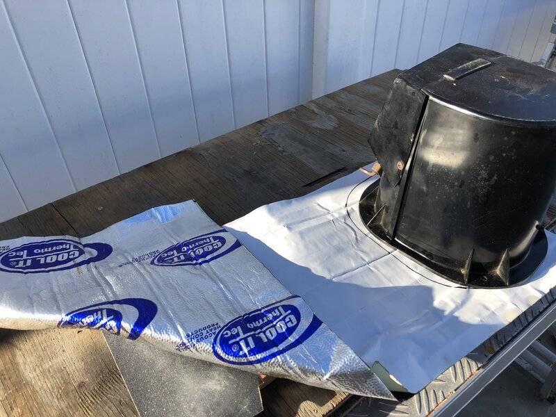

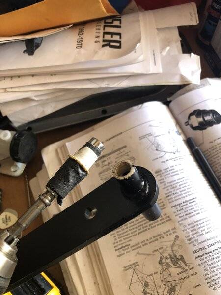

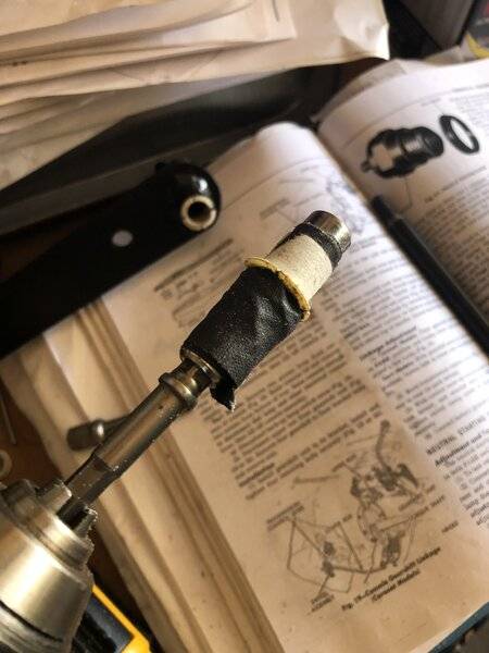

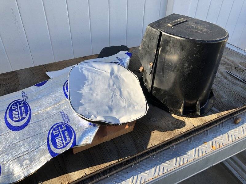

someone is going to have to remind me why I took this thing off and where did the original gasket went. anyhow, glad i have spare Thermo Tec Cool It stuff laying around. making a gasket for it now.
what does this have to do with a 727 to Tko500 conversion anyway....rhetorical question.

It's just stuff that's in the way when installing that 3rd pedal bracketry. :)

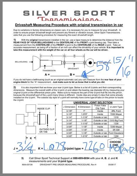

nothing else to report other than cleaning up wiring and sent in driveshaft measurements to SST. they estimate a few weeks for delivery. i’m ok with that - heck i’ve milked out this conversion for nearly a year.
a few pics
notes for driveshaft on order form (old revision)

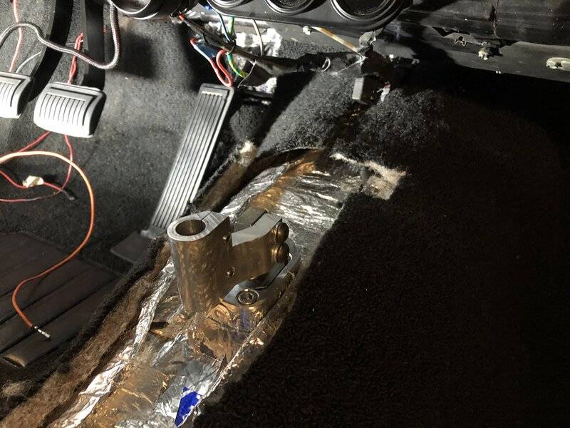

correct way to mount shifter bracket for a 66 application - that’s only if you want the shifter in the center of the console shifter opening
