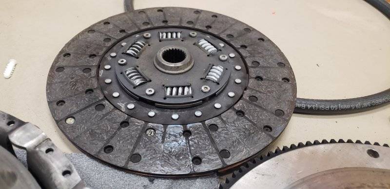

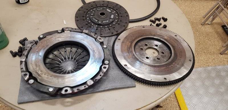

Mcleod dual friction clutch. Very disappointing. It is supposed to handle 500 HP. My 383 was only 300 at best. The car was on the dragstrip a few times, and spent a weekend on the autocross track. The 383 engine is out right now, my 505 stroker is going in. So I have to decide on what to do with the clutch. This is mostly a street car that does see the drags and autocross. I want an easy clutch for daily driving, but as we can see, it did not last long.
I can put a Mcleod ceramic disk clutch plate in it for now. That may fair a little better with the stroker motor.

Mcleod clutches take 500 to 700 mile break in before you can load them fully. I am going to the Duct Tape Drags in 3 weeks. No time to break in a new clutch. I am thinking about just throwing a new disk in it as it is. Give it a quick sanding with a big flat board and a new disk. Either the same dual friction it it now, or full ceramic. Hopefully bypass the breaking in of a completely new clutch. Does that work?

I don't think a single ceramic/miba disc would hold behind your new engine.
Not sure why your first clutch is that destroyed behind a 383.
(Edit- I see from your old post it was first behind the 505 so not really surprised)
Hydraulic throwout? I'm assuming you had enough free travel and it wasn't preloading the pressure plate.
I use the McLeod RXT with organic discs and it drives super nice. Light pedal and smooth engagement.
How long it would live in a drag racing environment behind a 505 would depend on how much it's slipped.

Roll the pressure plate over and snap a pic of the fingers. How did you adjust it? Is that a 10 1/2"?
It's kinda hard to tell what happened without knowing how you 'leg' the clutch or how you set it up. If a clutch has the right settings and pressure, it shouldn't be slipping like the pics show it has been doing with the power you say it has. How much free pedal did it have and are you 'easy' on lifting off of the pedal during shifts or do you try to make a smooth shift by not letting off the pedal quickly? I've even seen guys using the clutch to keep the car from rolling backwards on a hill at a stop light! That's a big no no too.

It was first installed behind the 505 which he said easily drove through the clutch.
So, was probably already glazed when put behind the 383. (Just my guess anyway)

Too many people adjust the clutch by free play at the pedal only. I did that once. I smoked the throw out bearing and it ate the pressure plate fingers. Since then I adjust the air gap between the bearing and fingers. As long as there is a slight gap the clutch will operate perfectly.

And that should give you some free play at the pedal too, right? At least with a mechanical linkage system I think it should/would. I don't have much if any experience with a juice setup....

Yes it should. Every linkage piece has a little play where it attaches to the next piece. All that play add up to your free play.

There's no air gap with a hydraulic throwout as there is an internal spring that keeps constant pressure on the pressure plate fingers.
You do have to shim it so it's .175 (or so) from bottoming out however. (as the fingers will move away from the pressure plate and into the throwout as the disc wears)

^ It's a rather light spring inside the hydraulic throwout but necessary. Takes up all slack and makes it automatically adjusting. (can easily compress it with 2 fingers)
