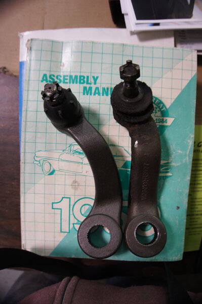

the majority of the new parts were dimensionally different from the old ones-mostly in thickness, but the idler was shorter and needed a shim, the pitman was a a complete change, I called the supplier when I got it, they said it would work with the new steering gear. I'm going to re-install the old pitman and idler-see if that makes a difference and maybe I can identify the problem. Photo shows new and old pitman-new on left.
the majority of the new parts were dimensionally different from the old ones-mostly in thickness, but the idler was shorter and needed a shim, the pitman was a a complete change, I called the supplier when I got it, they said it would work with the new steering gear. I'm going to re-install the old pitman and idler-see if that makes a difference and maybe I can identify the problem. Photo shows new and old pitman-new on left.View attachment 970620
