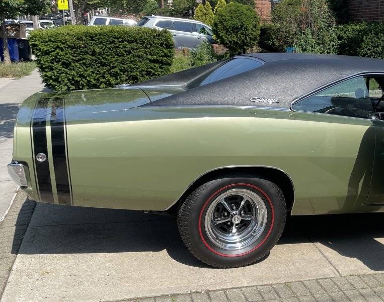

Running a 440 six pack, 4 speed, dana in a 68 Charger. Car was originally a 383 2bbl car with stock torsion bars. When I get on the car it just feels very soft and sloppy. The tires will break loose at 35-40 mph easy. Do you think its the bars or should I look at the steering more closely. Could it be the 15" redline radials causing the sloppiness?. I never had this problem with wider glass belted tires.

My Jigsaw Charger had the stock .88 torsion bars but a big sway bar and KYB shocks. It steered okay and handled pretty good but the front felt too soft.
It would wallow/porpoise instead of feeling steady and controlled. I swapped in a set of 1.03 torsion bars and it feels a LOT better.
