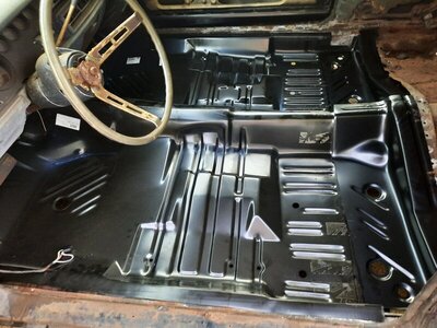

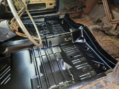

Yes, I did while replacing the floors in my Roached Runner.
20210807_203010.jpg 20210807_203004.jpg 20210811_195848.jpg 20210811_195841.jpg
Weld through primer sucks, at least the Eastwood does: Floor replacement- front seam
