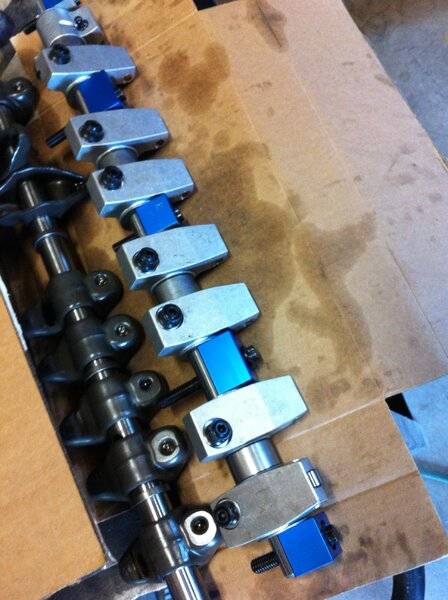

The TF240 is a good head. The recommended HS rocker arm set has gotten really expensive for those heads. Not sure what alternate choices there are?
The T F 240 requires a unique rocker arm arrangement?
I have these Mancini racing 1.6 rockers that they claimed were made by Harland Sharp. They fit fine on my Edelbrocks.
They won't work with the TF 240s? What is changed that requires a different setup?
It's not so much that they 'require' a special rocker, but they've relocated the stands slightly for better geometry with the HS rockers. I (think!) they figured since all the aftermarket stuff is a little different, they picked the Harlands to use as their template and went from there. Our Edelbrocks are basically modeled after the factory heads which throw the swipe pattern off a bit with pretty much any aftermarket roller rockers.
This gets into that whole 'when should I correct my geometry' argument though:poke:
Honestly I don't know why the Mancini rockers (that's what I have too) wouldn't work the same as the HS-branded rockers, unless their different dimensionally. I haven't compared the two side-by-side but they look the same to me.

Trick Flows = Best bang for the buck going on.
It’s interesting how distorted information gets on the ‘net.
The HS that are recommended by TF for their heads are not “designed” specifically to use on TF heads.
The “E” in the part number is actually for Edelbrock.
The “normal” HS rockers are a little too long on the valve side of the shaft for Edelbrock heads.
So HS tweaked them a little, and gave them a separate part number.
The HS “E” rockers existed before there was any such thing as TF heads for BB Mopars.
Apparently, when TF was designing the heads, that’s the rocker they were using to determine the relationship between the rocker, rocker shaft saddle, and the valve tip.
Basically, rockers that fit Ede heads properly....... will fit TF heads very similarly.
It’s not a big deal.
