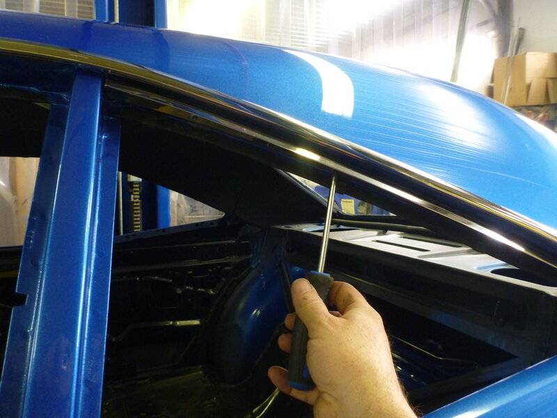

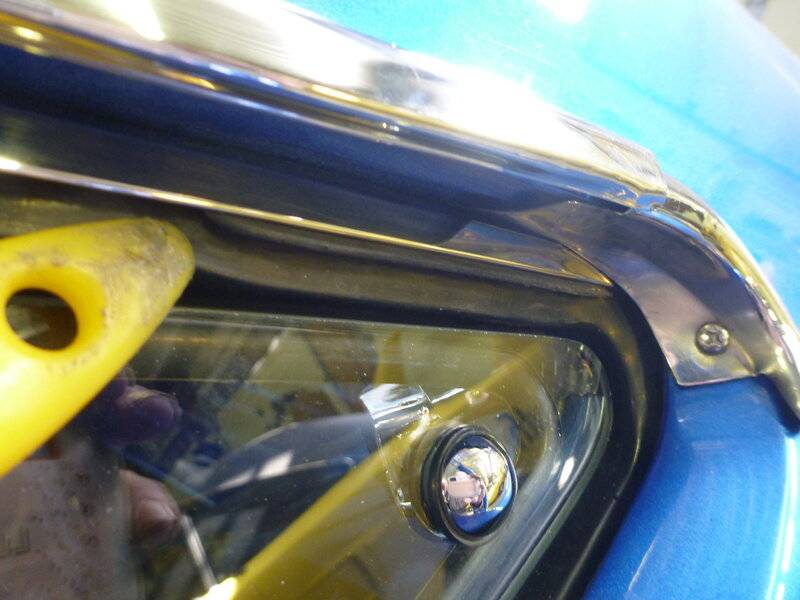

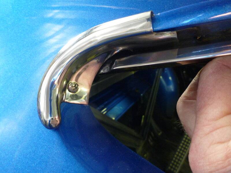

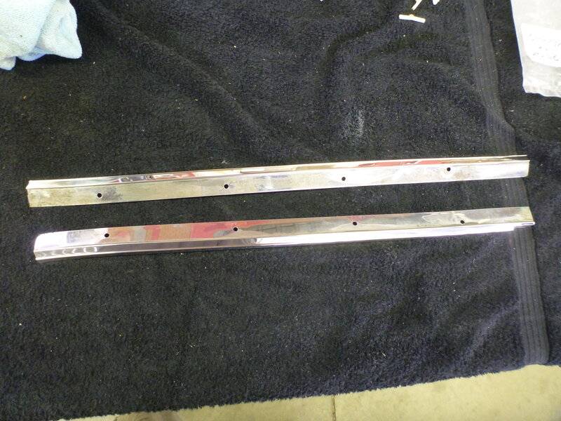

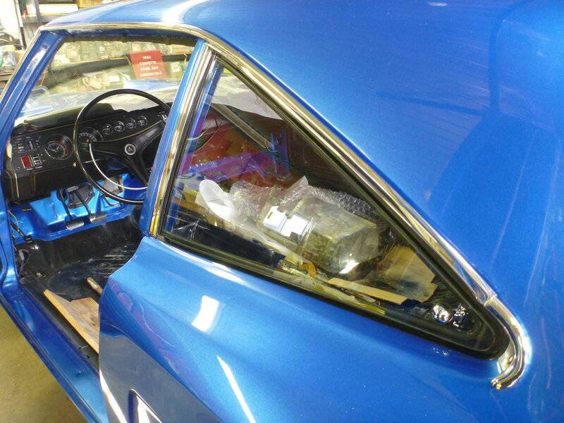

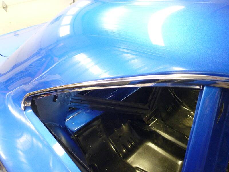

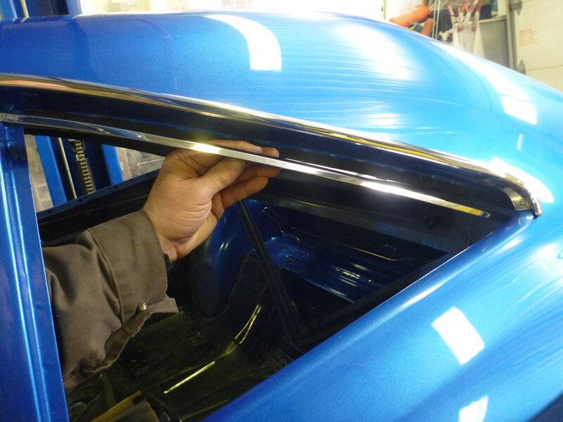

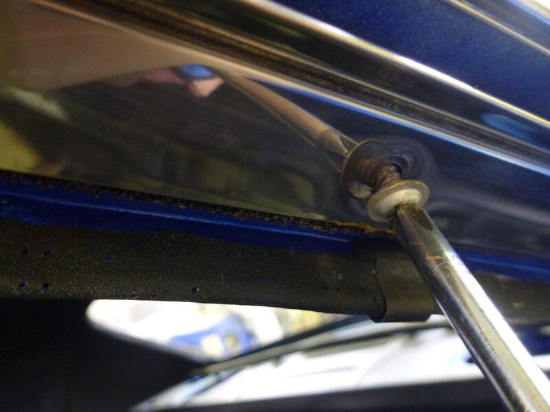

Sorry to bust your bubble, but YES... It has to go in first, then your roof rail, then your window assembly.

Ok, I will tell my friend the bodyman was correct. Thanks for you help dadsbee.
I guess I must be missing something - the drip rail SS and rear turndown was some of the last assembly and trim we put on his post Roadrunner and he gave all of that to me put on one morning - which I did. The Windows had been in for months. Maybe some subtle difference on Dodge - the drip rail cap on dadsbee car does look wider and more substantial than the simple gutter lip trim on the Roadrunner, although the turn down looks the same. That may be the difference.
The rearmost trim curl has a plate on the upper portion that goes up under the roof rail trim plate. Not sure how you could stuff it in after the fact, but I guess it's possible it could be stuffed in after the fact pending hammer selection.

Unfortunately I don’t have that many photos of his car but it looks like the Dodge might have a SS plate spanning between the underside of the drip gutter and the window frame that his Roadrunner doesn’t have. His has exposed painted metal between the gutter bottom and the window frame. His plate on the curl didn’t have to slip behind anything - it’s exposed.

Post Bee has roof rail trim front and back, just like a hardtop would for rear roll ups..
