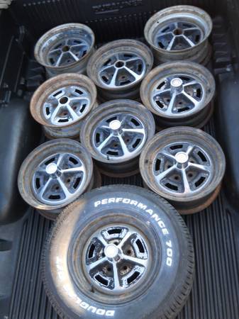

Here is a shitload of Road Wheels for sale in Colorado.
https://cosprings.craigslist.org/wto/d/pueblo-mopar-magnum-wheels-or-road/7436481902.html

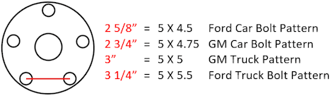

5 X 4.5 Bolt Pattern Measurement and Specifications
The 5 X 4.5 Bolt Pattern or Pitch Circle Diameter (PCD) is made up of the stud count (5) and the bolt circle measurement (4.5), the notional circle determined by the center position of the studs.
Equivalent Bolt Pattern: 5 X 114.3
How To Measure 5 Lug Bolt Patterns
Measure 5 lug wheel bolt patterns from the outside edge to center distance between two studs that are across the hub from each other. This measurement is your bolt pattern diameter. Learn more about wheel dimensions.
Alternate 5 Lug Bolt Pattern Measurement
Alternate 5 Lug Measurement: 2 5/8" Center to Center = 5 X 4.5 Bolt Pattern.
What Vehicles Use Wheels With 5 X 4.5 Bolt Pattern?
The 5 X 4.5 bolt pattern is common to FORD, MAZDA, LEXUS, TOYOTA, MERCURY, MITSUBISHI, HONDA, DODGE, NISSAN, ACURA, CHRYSLER, INFINITI and other vehicles. A full list of vehicle makes and models appears below.
5 X 4.5 is generally thought of as the 'Ford Bolt Pattern', or passenger car bolt pattern, and is a very common bolt pattern found on travel trailers and utility trailers. More about trailer wheels...
5 X 4.5 Bolt Pattern Torque Sequence Specifications: 1, 3, 5, 2, 4
Note: Alloy wheels should always be installed using a torque wrench ensuring proper mount. Check your vehicle owner manual for proper specifications. General recommendations by stud size in Ft/Lbs: 12mm = 70-80, 7/16 = 55-65, 1/2 = 75-85, 14mm = 85-95, 9/16 = 95-115, 5/8 = 135-145
It is prudent to re-torque wheels after about 60 to 90 miles (100km to 150km) of driving. Learn more about lug nuts and torque.

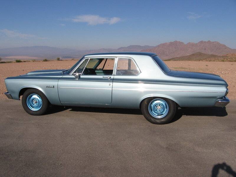

I use a crown Vic wheel as a spare on a 70 b body, I'm sure there are millions of steel wheels from them in your local junkyard.

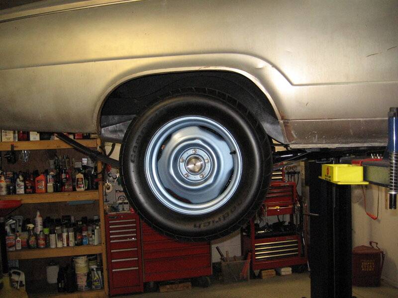

Modern/late model.Tho from the late 80's the Dodge Diplomat/Chrysler rear wheel drive cars came with 15x7 with the correct 4 1/4'' backspace. Ran them and still do on many of my cars.Once cheap are now in the $25-$50 range each.
These were 15x6 front and 15x7 rear.
Have you checked to make sure the wheel will actually work on your Mopar? My experience is that the Ford center holes area bit too small. That holds the wheel off from the hub just a little bit and makes the lugs work loose quickly. I nearly lost a wheel on one of my Coronets due to this once. Learned a valuable lesson.
I have several sets myself and have widen a few pairs for the rear.
