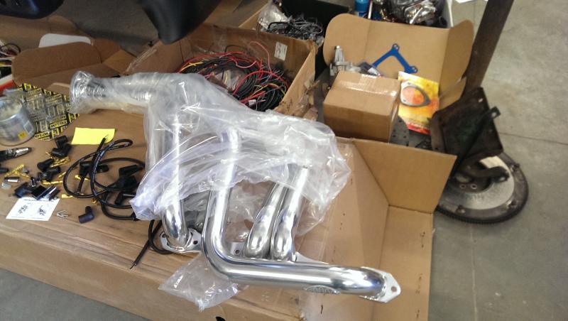

Here' a pic of my Doug's... now don't tell me those aren't pretty!

Thanks for the feedback guys. I think I will go with Dougs but in the black ceramic coat...
