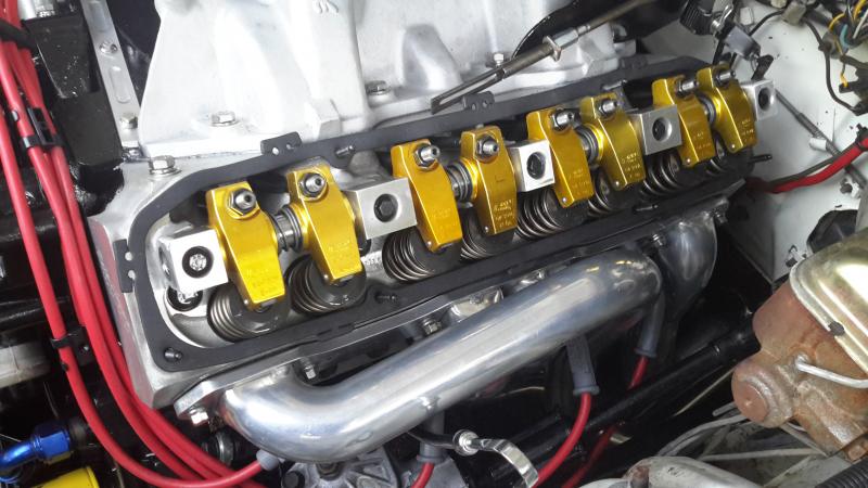

TTI 440-200 cermaic coated Eddy RPM heads headers fit great , but you must modifie kickdown bell crank, 20150916_181726.jpg00I0I_jmXuS6liH7Y_600x450.jpg00I0I_jmXuS6liH7Y_600x450.jpg

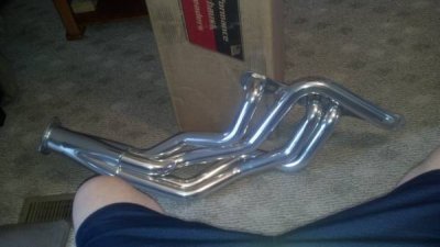

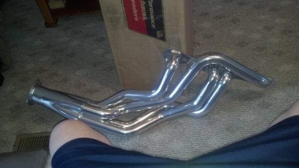

I liked (and bought) TTIs. I liked the 3/8 flanges, and overall quality. Yes they are a little pricey but I have been regretful in the past buying a cheaper header.IMG_20160128_180003.jpg

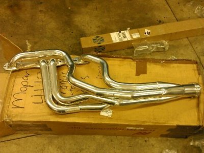

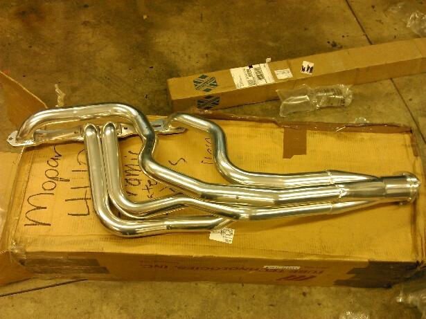

I did score these new unused for $750 off ebay. They are the ceramic coated with thermal coating inside.
