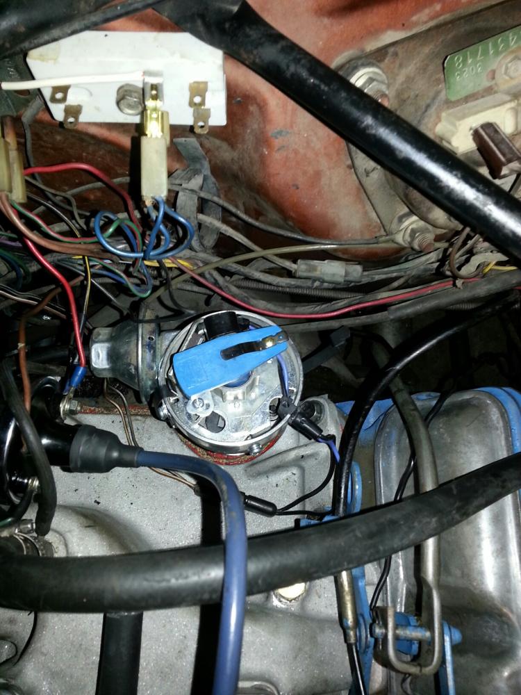

Now align the #1 spark plug wire with this and do the correct order? Got it.
Its supposed to be 16* btdc for initial timing, does that look about right?
Yes, the #1 spark plug wire on the dizzy cap should be right at the 2 oclock position so that it matches where that rotor is pointing.

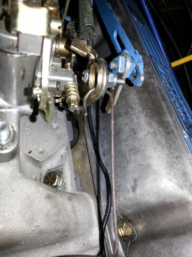

What would happen if something, say a nut or screw or something like that fell into the u shaped passage over the crossover passage on the head? Cuz that could have happened. u port.jpg
On my RB motor, I've personally dropped a few things in that same U shaped area: accelerator pump cam, and a nut or two. Car still runs fine and made no odd noises afterwards. I keep trying to figure out whether that U shaped area leads to the motor interior, but that doesn't make sense that it would. On the small block, not sure.
The fan's not hitting anything is it?
Does the car sound better now while trying to start compared to the other times?
Yes it sounds better. I feel like it might start if it werent for that weird noise. Its almost sounds like it threw a bolt out and the bolt hit something metal. Thats what i thought it was the first time. I checked the fan and it doesnt appear to be hitting anything.
I doubt that passage doesnt lead anywhere because why would it be left open for dirt and water to get to it?
