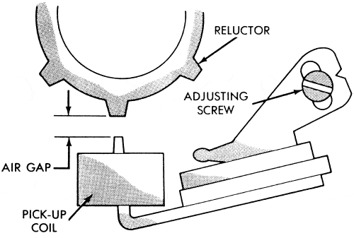

While your at it recheck the air gap on the pickup. I think .006-.008 just to rule this one out also. And like 440beep stated please double check and make sure you
hooked up the wires correctly for the new electronic ign. harness.
Yeah and if i add gas it just backfires and makes noised from the carb. The airgap on what pickup?

If you take the dizzy cap off and the rotor, this is what you should see, of course not this simple. Need to double check that airgap with a brass feeler gauge as the pickup coil is magnetic.

With the battery disconnected, checking roughly like this.
iirc, a matchbook cover is just about the right thickness to check your air gap. Works on point gaps too, I think. If I'm wrong, correct me quickly...I don't wanna send 74R down a wrong path.

You are correct. DAMN GOOD POINT!!! Forgot about the matchbbook cover I had in my glovebox for checking that. yes, use a matchbook cover if you don't have a brass feeler gauge.
