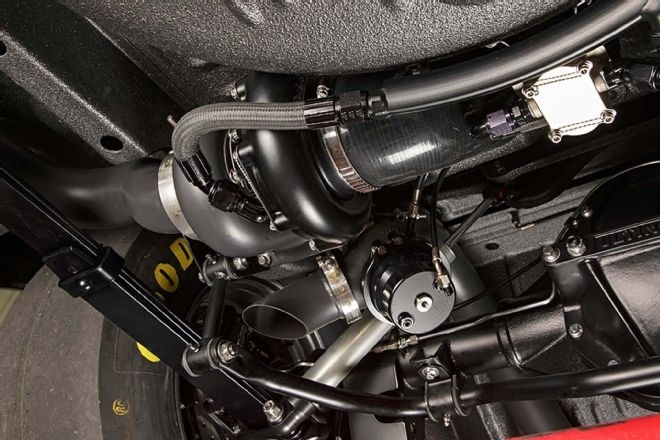

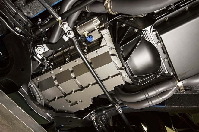

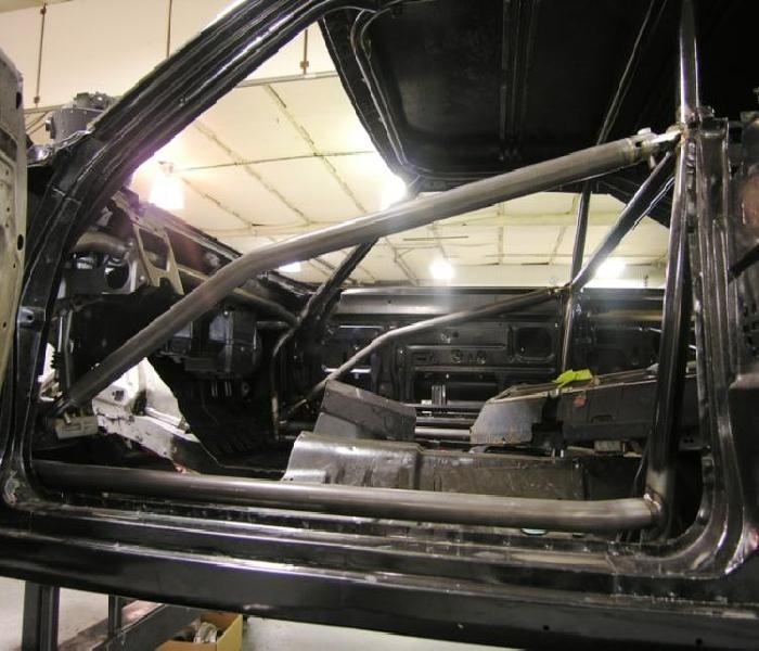

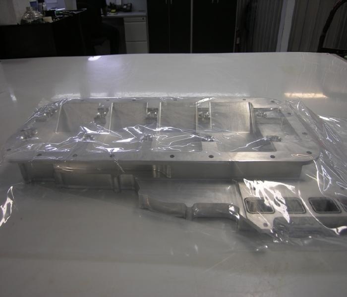

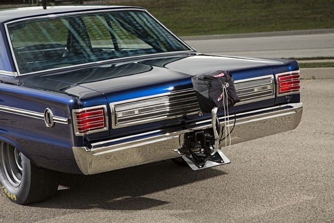

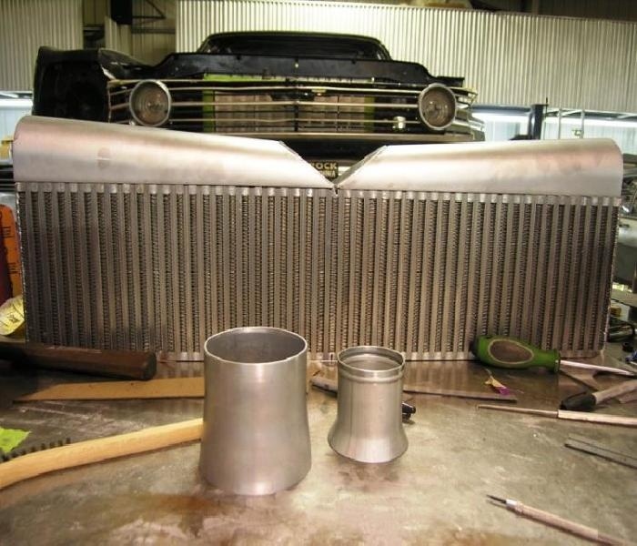

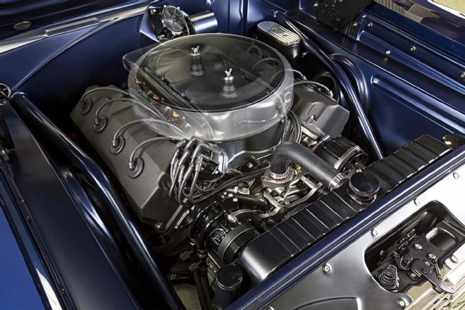

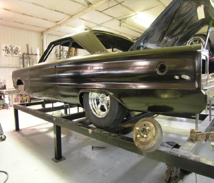

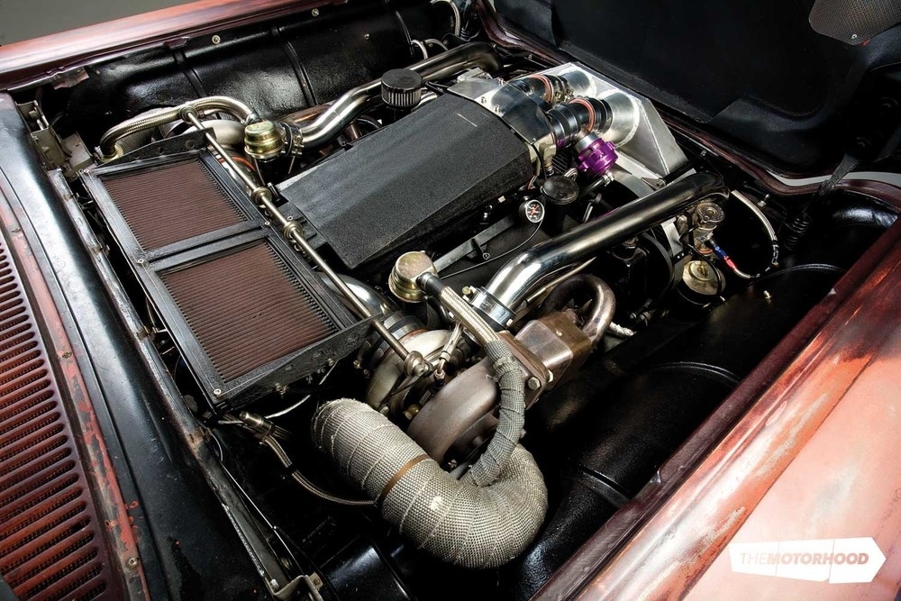

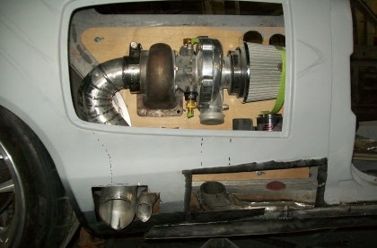

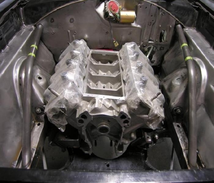

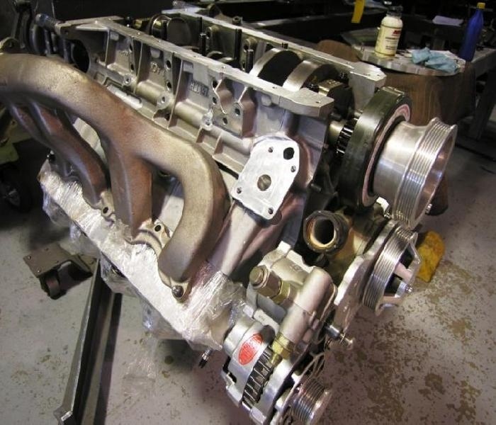

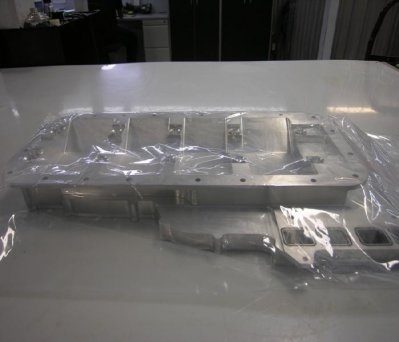

Check out Rad Rides By Troy
maybe call & talk to him {Troy} he' s great guy
he was building a 66 Belvedere alum. gen 2 Hemi with twin rear mounted turbo's
66 Belvedere Hemi Rad Rides By Troy #1 Twin Turbo rear mount.jpg 66 Belvedere Hemi Rad Rides By Troy #2 Twin Turbo Hemi.jpg 66 Belvedere Hemi Rad Rides By Troy #4 engine Hemi exhaust.jpg 66 Belvedere Hemi Rad Rides By Troy #6 engine oil pan dry sump.jpg 66 Belvedere Hemi Rad Rides By Troy #7 Inner-cooler.jpg 66 Belvedere Hemi Rad Rides By Troy #10 ready for SEMA.jpg 66 Belvedere Hemi Rad Rides By Troy #9 ready for SEMA.jpg 66 Belvedere Hemi Rad Rides By Troy #12 ready for SEMA.jpg 66 Belvedere Hemi Rad Rides By Troy #3 cage.jpg 66 Belvedere Hemi Rad Rides By Troy #11 ready for SEMA.jpg
View attachment 332067 View attachment 332068 View attachment 332069 View attachment 332070 View attachment 332071 View attachment 332072 View attachment 332073 View attachment 332074 View attachment 332075 View attachment 332076
I'm digging that setup, can you actually talk the Troy????? This is basically what I had envisioned for a rear mount so it's nice to see it actually being done.
I don't know
He may be really busy BUT;
I did talk to him a couple times about 5-6 years ago...
He was gracious & talked to me for about an hour the 1st time,
I was talking with him about the bad *** Torino he built
& a 32 Ford with awd & some of the parts he used...
