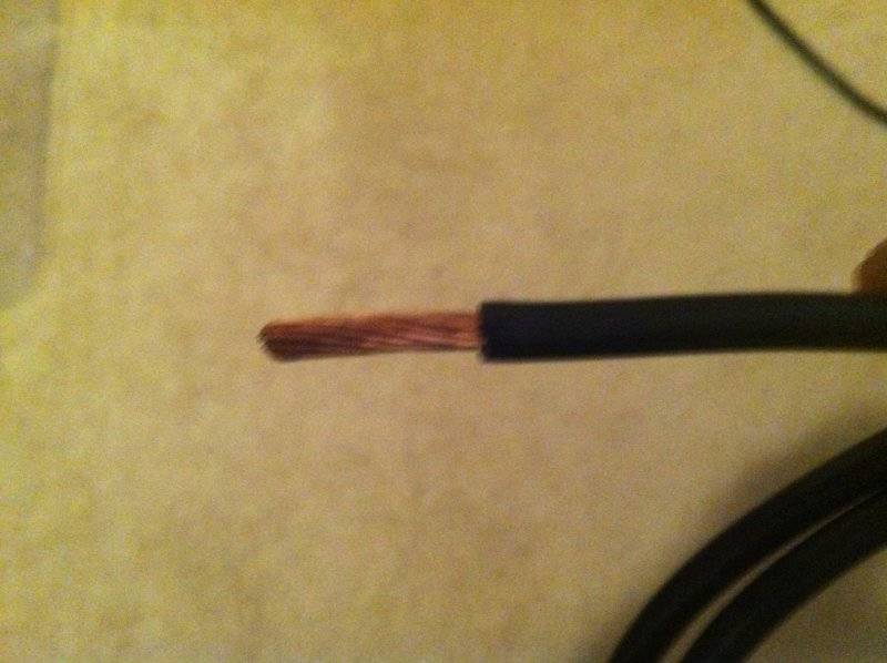

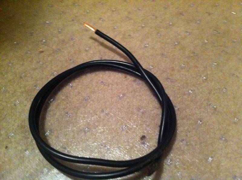

Steve, Here's some pictures of the 8 gauge wire I used, it is a very rigid wire. got it a NAPA.
View attachment 797982 View attachment 797983
thanks Moe. The wire I got has lots of strands. What it looks like is 6 or more larger strands made up of many smaller ones.
I thought the more strands the better. It is very flexible. I just wonder if its ok to use

The higher strand content bends and crimps easier. It is more expensive. There are some performance attributes, but they do not come into play with DC circuits. (think high end audio cables heheh) If you can't find what you like locally, check out this place, I've had good results with them:

I got some #8 with fine strands. I just read were high strands are better and also #8 is adequate for my alternator. I should have known about the welding cable, its all fine strands ...Thanks
Yes it is OK to use that wire.
