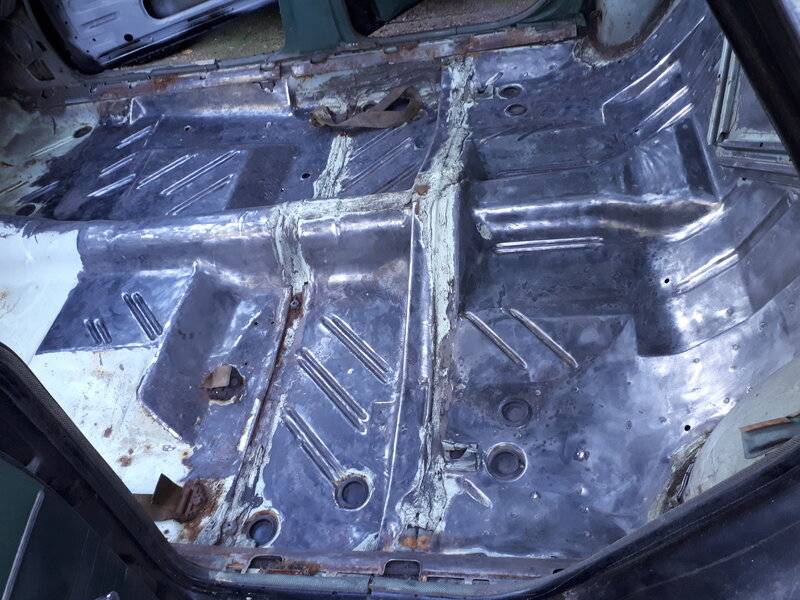

POR-15 everything and weld in patches
Not a bad idea with the stands and 2x4.. i picked up some "dupli color professional rust barrier" to use on the interior and i might just use it for the under side aswell, kinda have the mind set that it doesnt have to be the prettiest as itll be under carpet which is why im not just painting it.. pic is my progress with removing old rust and paint
