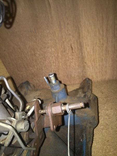

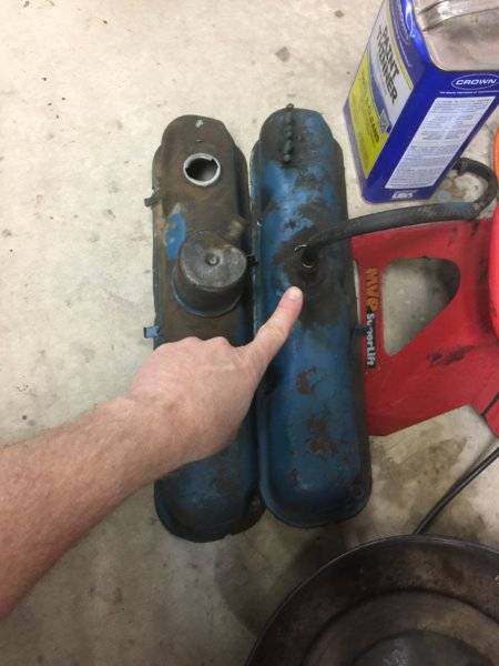

Hey why is the driver side valve cover ported to the manifold vacuum? This looks like this is how the stock set up was on my 318 but not sure. Why is this needed?
Is this to help vent the driver side valve train? Can I just vent this via a large port that I will have with my new valve covers?

Crankcase ventilation would be my guess without seeing a pic.
Yes it sure looks like positive presure venting to manifold vacuum. Again not sure why maybe an environmental efficiency thing? Either way looks like I can delete this and vent to the atmosphere?!?!?!?
On my 318, the valve cover part you're pointing to is the pcv valve and this runs to the back of the carb. The other part in your bottom pic is where the brake booster check valve hose goes.
Thanks J. Mine was not connected when I got the car so it was an assumption. What you described makes more sense. The bottom pic is probably manifold vacuum which is what we need for the power assist brakes.
The top pic is what is still confounding me. The carb connection you speak if must be also manifold vacuum. Then why vent to the vacuum other than to be more efficient to vacuum out more air from a small diameter hose to releave pressure? I believe this is why. Crankcase ventilation adequacy is often not well understood at least by me..... Can Anyone else help explain this?
You get blow by in your motor and without pulling the gas out is can make seals weep. That is all I know that can happen by not having a pcv system in place. They did do it for emissions as well to re burn that blow by gas. The big nipple on the intake looks to go to the brake booster? Small is vacuum accessory.
