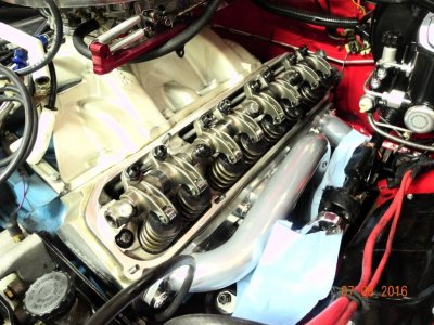

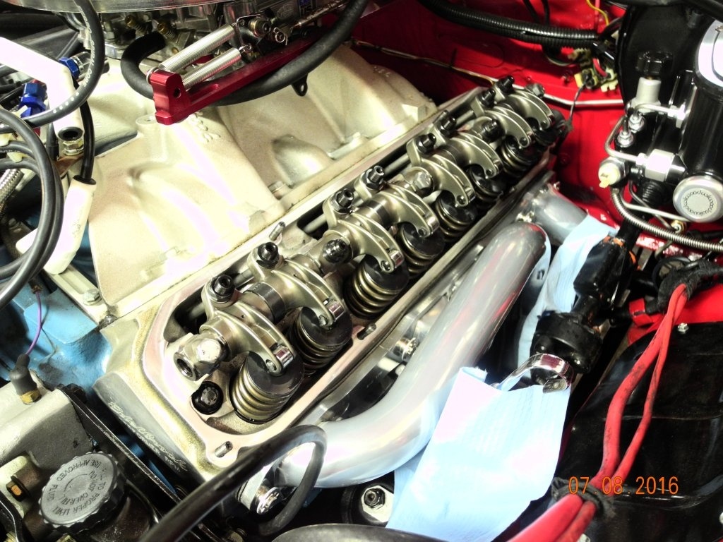

I think it's easier to set valve lash with a solid lifter cam, then you don't have to determine where zero pre load is. I just did mine today, since I just upgraded my 440 with some Eddy Perf RPM heads and Crane Gold Roller Rockers.
