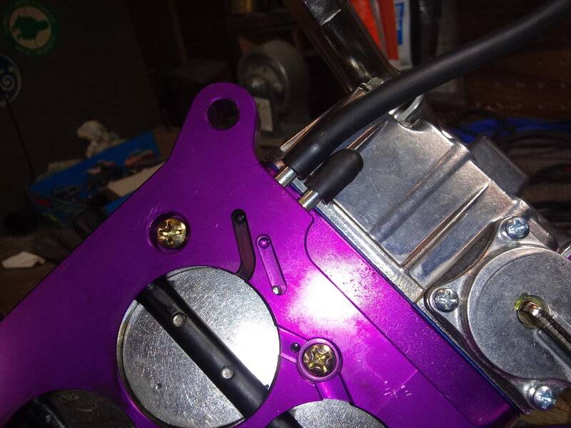

[QUOTE="daytona kid, post: Here's a question, which of the 2 fittings should I have my vac advance hose connected to? Before or after the butterflies?
View attachment 993368[/QUOTE]
The one towards center with the plug appears to be ported vacuum. That would be the normal location. The ported location will only pull vacuum with the throttle open. The other port will pull at idle.
Doug
I'll swap them and see what happens. I've been curious if I had it on the correct one but it cranks, idles, and runs ok, until the hi revs, so I left it as is. Probably not the cause of the problem but may improve something. Thanks Doug
Try running it without the vacuum advance hooked up
Plug those ports on your carb
Just run your mechanical advance
See what happens

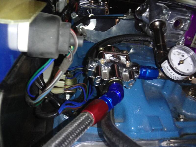

Still have not done any more test runs yet, but I may have thought of something that could be the problem or part of it anyway. I put a holley regulator in the fuel line right before the carb. It has 1 inlet and 2 outlets. I plugged 1 of the outlets and ran the other to the carb's 1 inlet dual outlet feed line. Thinking about that now I'm wondering if that is cutting the fuel flow in half, and causing starvation. I guess I should do what someone suggested earlier and check how much it is flowing. May have to replumb the line/s.
The dyno here has two of those on it, plumbed using only one outlet each.
I’ve tested motors making 800hp using only one regulator/one line...... no issues.
Thanks, that's why I post stuff like that before I do it. Now I can forget that possibility and not waste time and effort. I think I asked someone if it was ok plugging 1 side when I put the regulator on.
