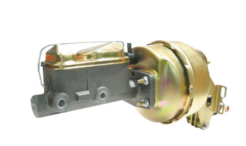

All the brakes are new as with the master and no leaks. Everything is new except the booster. The brake kit came with a new booster but it was one of thos eones that stick out from the firewall. So I elected to use the old booster. Here is where it gets stupid. I'm pretty sure the booster is bad or has an internal leak. When I fired the 440 up in the satellite it sucked the brake pedal to the floor. I assume the booster is shot. Has anyone ever had a booster do this?

Are you using a single-diaphragm drum booster on a converted to disc car? Won't work.
Suspect not enough free play in pedal closing compensating valve allowing engine vacuum to act on diaphragm and apply.
That might be the problem... Damn it.. I used the old booster.. I have the new one Ill install that..
This could also be the issue.. Im going to install the aftermarket one from right stuff and see if that fixes the problem.

Well, I replaced the booster with the one that came in the right stuff kit. However now I have a really low pedal. The car will stop but the pedal is almost at the floor.
I adjusted the pin as shown in another post by another guy. Anyhow I think I know what the issue is. It still has the drum brake proportioning valve. I will get a disc brake prop valve and hope it fixes the issue.

When using that wacky booster and master I posted above.. It hooks directly up to the brake pedal. You remove the original linkage and spin the new push rod out to adjust he pedal height. I have that set up to close the contact on the brake light switch. But no matter what, the pedal is really low to the floor. The brakes are working but it would be a scary situation in a panic stop.. As I mentioned before I also adjusted the push rod coming out of the booster into the master as noted in another post. I didn't have the tool they used but was able to get it very very close.
