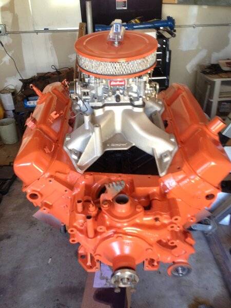

I had done my engine with that paint.
I did use the engine enamel primer as well before the Hemi orange top coat.
How close the colour is to correct i have no idea but it looks good, glossy finish.
The paint stays quite fragile after spraying, it requires heat to be "baked" and harden, since i was still far away from running the engine after painting i went over it with a heat gun to help the hardening process.
The engine is in the car now already for 8-10 months and the paint still looks like new.
When you do the first start you will get some nasty smell from it but that's normal with these paints and will go away after some time.

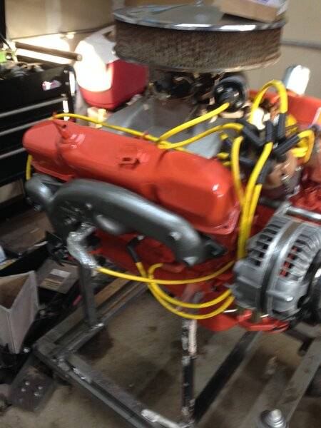

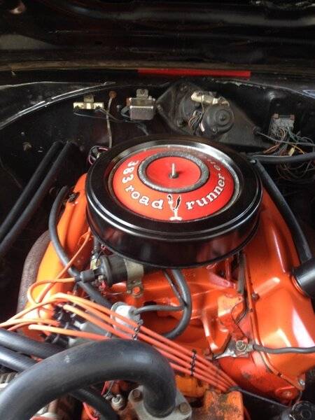

I did use it but I screwed up I used the HP manifolds painted when I did my cam break in. I should have used headers and did the proper burn in on the HP manifolds. I think its like 20 minutes and cool and another 20 minutes and cool. There are instructions on the can but like I said it was my fault the paint failed on the HP manifolds. I ran it for 20 minutes to break in the cam but it was higher RPM's and the manifolds got super hot during the break in.
This is a picture of them before the cam break in.
Here is after.

Oddly they still look like that but a little surface rust. The engine was sold to my neighbor before I could stick it in the belvedere. I don't know what they actually look like now. But after the cam break in the paint turned into a pink like powder. But last I saw they did remain that color hint of surface rust. The ones you see painted on the 383 with the moroso pan were only primed. I never painted them other than the primer.

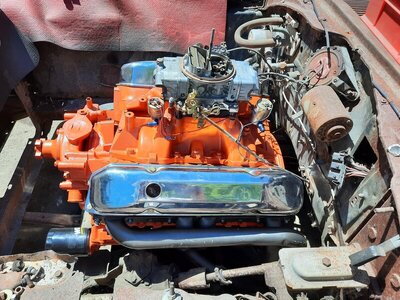

I use VHT and plasikote. Whichever is available for me at that time. Both look good when done. My 440 six pack, Hemi and 383.

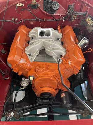

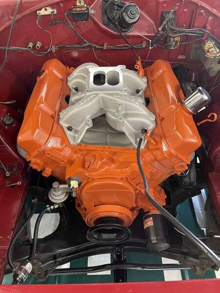

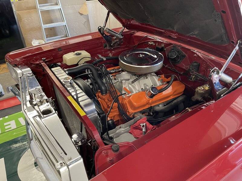

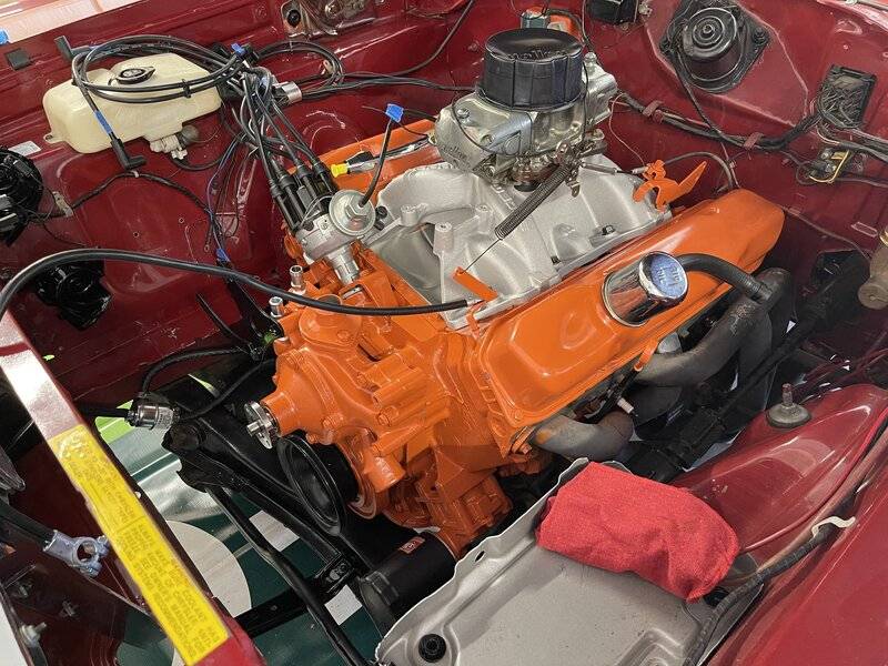

I’ll definitely give the VHT hemi orange paint my endorsement. I cleaned up my 69 GTX motor with it recently. My advice, follow the instructions exactly. Let the paint cure for 7 days between coats.
857C47CB-72A3-4CF3-B77E-1D04FF33F958.jpeg 662BC7EF-44A3-4210-8440-D313D27E80D8.jpeg 2DC880E3-9F49-43B6-B26A-2FA80AF362D0.jpeg
