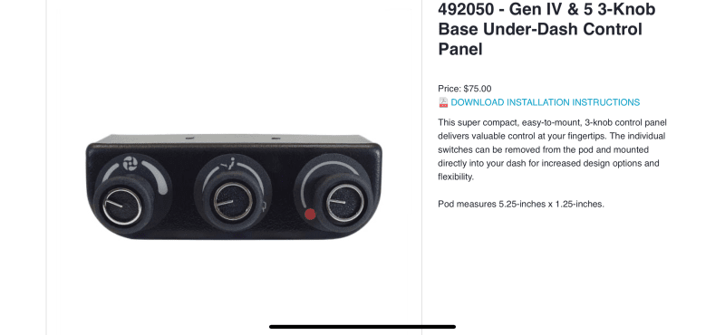

I got this. All three switches and stickers are individual. I’m going to make a piece that will be lit to fit in the area where the factory controls were. Should fit perfectly. I’d rather have something stock looking but for $40 bucks on eBay, it’ll work for now.

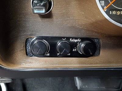

This is the control panel I installed. Got a piece of abs plastic and used it to attach behind the cluster. Didn't have cut my original.
here is a photo of the abs bezel I made to mount behind the dash to hold the controls.
