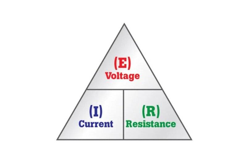

Voltage drop is simply down to how and where you measure the voltage at two points.
You are measuring the amount of drop in a circuit across two points of resistance.
BTW, I am not a Professor of Electrical....I just get **** done. Been doing it long enough. :D

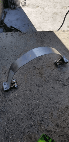

All steel construction. :p

It may be overly simplifying the OPs issue, but in order for anyone to understand voltage drop they should understand the why. I & E being proportianate and inversely to R
9 times out of 10 in a DC circuit there is a resistance in the circuit that has changed causing the issues. Either corrosion, or contact tension usually being the culprit which all subsequently lead to the coup de grace' of any failing electrical system - heat.
