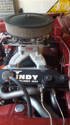

I gathered a lot of info at test n tune today.
The short story is that even though the dyno liked the spacer, the track didn't . Not today anyway.
I started with 98 jets and a 2" spacer.
First pass it stumbled and went 10.16@ 134.32.
Next I took off the spacer and kept the jetting the same.
It ran 10.05@ 134.02. Still stumbled a bit off the line.
3rd pass I jetted down to 96s.
It went 9.90 @ 136.46.

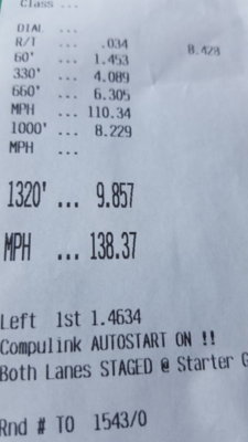

The last pass I left everything the same but I stuck the air cleaner on.
9.85 @ 138.37 !!!
I wish I had a little more time to play, but I'm not giving up on the spacer.
9.85 @ 138.37 !!!

The third pass I leaned it out and ran better. Picked up 2 mph. Then picked up another 2 mph with the air cleaner.
The front end isn't coming up because I have about 120 passes on my tires. Lmao
That's next on my list.
It was also stumbling off the line. Ill clean the carb out real good this week.
The old setup liked to leave off idle so thats what i was doing with this.
Ill try getting up on the converter with this setup.
