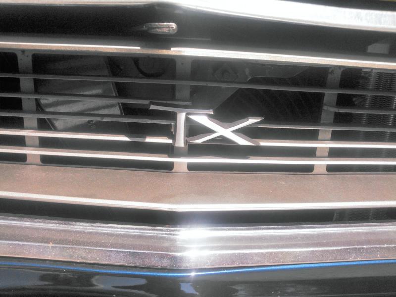

Guess I went too fast yesterday. I blew the G off my grill emblem. Last run was [email protected]
The motor sucked it in and spit it out. Good thing a Chevy wasn't in front of you.

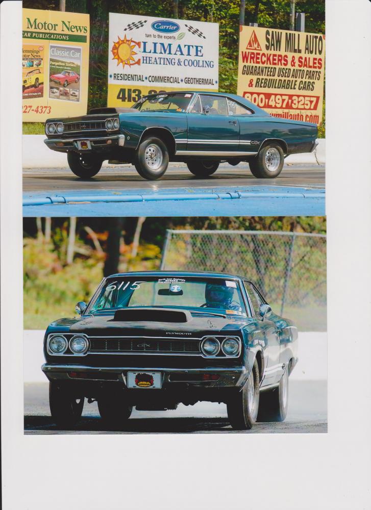

Beautiful day at Island Dragway yesterday Air temp didn't get above 60. Humidity around 50%. For those of you keeping score, this is what I did.
Saturday afternoon, I took the distributor out and put lighter springs in. Adjusted the timing and put the car away. Drove to the track on Sunday morning and got the car ready. Left the "exhaust" on because I could. Put the air in my tires down to 19 lbs to start. First pass the car felt good off the line. When I got to the top end, it broke up a bit. Still a good pass (for me) Went [email protected] 1.59 60 ft.Best 60 ft. to date.I think because of the distributor. After the run, I went up on the jets. Started the car and it didn't like the changes at lower rpm. It revved ok after 3500. So I went back into the carbs and went down one size in the primaries only. I don't know if that was right, but it worked. Got it back together and it ran good. By this time it was a little warmer out. Checked the tires and aired them back down to 19. Made my second pass it it ran better this time, not breaking up. I [email protected] witha 1.59 60 ft. My 60 ft times were .030 better than anything previous with about the same e.t. So the final pass, I went down to 16.5 lbs. in the rear tires. Air temp went up a little more and full sun. The DA was about 800 at that time. Tires seemed to grab a bit more and went 1.58 60 ft. and [email protected]. Best e.t. and 60 ft. to date.

Geez bob you're sounding an awful lot like a race car driver.
Almost 40's, good job! Would've went 40's with open exhaust I bet. Great tuning.

the beast is a very impressive running car, just think what a solid lifter cam would do to her!!
Thanks, plans are for a solid roller and a Victor manifold and maybe a 950 quick fuel over the winter.
