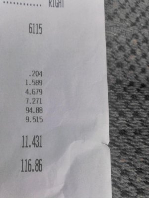

Does anyone have any experience with clamping leaf springs? I have seen that some clamp the front half and cut the clip off the back section. I don't have the ss springs,but the xhd ones. Looking to lose a little off my 60 ft. Times.
Have you considered Cal-Tracs? I've heard a lot of good about them. I'm assuming you don't have any already from looking at the pics of your car. I have some but a ways from being able to test them.
I just want to use what I have for the rest of the year. Racing again on Saturday. Maybe upgrade this winter if money allows.
I did this years ago with Mopar S/S springs.
2 clamps on the front of each side and removed the rear clamp.
Picked up a couple of hundredths and more consistency.
Also had C/E shocks set at 50/50 and pinion snubber set up at rest with 1 inch from the floor.
Not sure what you might gain with those springs though. Had them on my Belvedere when first put together but have since moved on to Caltrac monoleafs, QA-1 shocks and Caltrac bars.
Just something to try out for now. Maybe do a caltracs/ mono leaf over the winter.
Yep just use some 1/4" by 1.5-2" I did this back in the day. Cheap and your not out anything if it doesn't work. Also can try lowering the back end to help weight transfer.
Will this work without an adjustable snubber? I never put one in.
We'll have to talk Saturday after I beat you.
