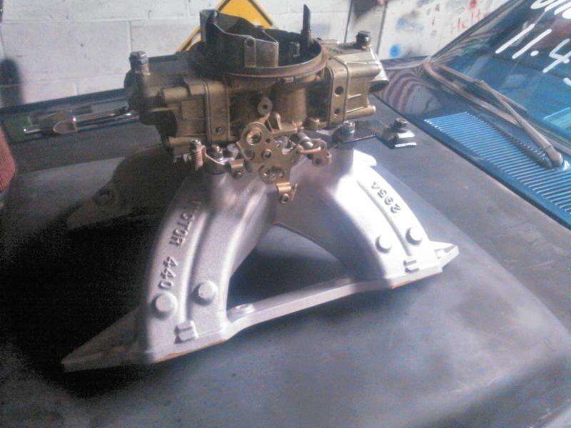

Here she is!
NHRA tech dept is probably asking.... So how's that roll bar coming along??
Haha
Nice score, that should pick it up.
One carb should make it easier to tune!
