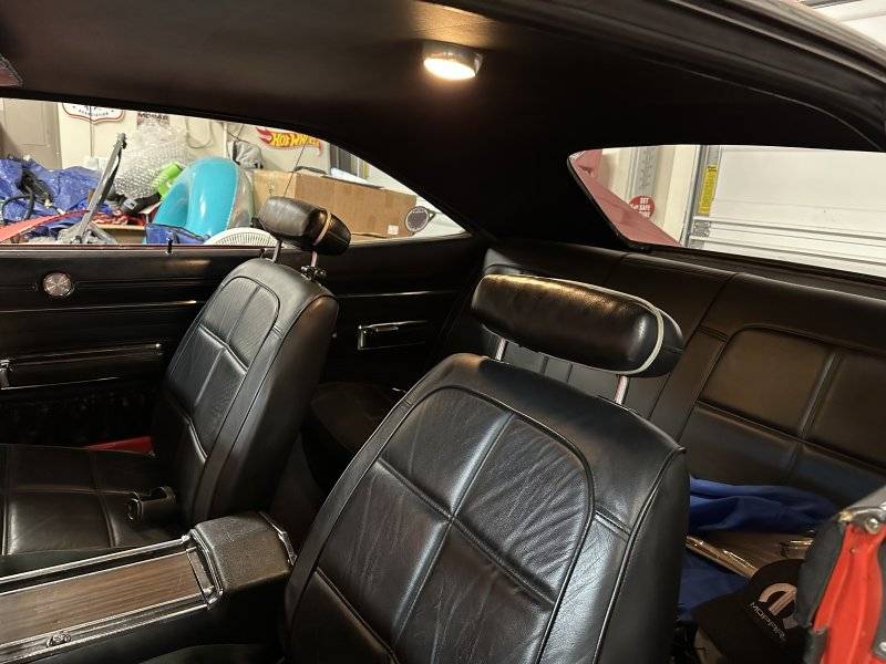

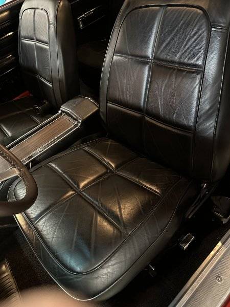

My car is a Real RTSE and a previous owner along the line, put black SE interior in my 69.
It’s originally a CRT coded Saddle tan.
Id like to switch it back.
Preferably the correct way. Unless I really need to repaint items that aren’t reproduced in tan.
I would be willing to trade or sell the parts that are reproduced in tan.
Anyone have any 69 Tan Charger parts?
Thank You
If you are going to do this 100 percent correct the dash frame needs to be repainted and everything from the headliner to the carpet, front window to the back window along with seat belts and all the other do-dads will need to be changed of painted. Tan is also not easy to come by. I went from tan to black so I know what I needed to do. Most of all my tan parts were pretty roached out. What was usable I re-colored them Black.
Looks like you have a leather interior? You'll need a water-based color, along with an adhesion promoter, and slip agent for the leather, and a solvent base for everything else. You'll have your work cut out for you for sure! Good Luck
