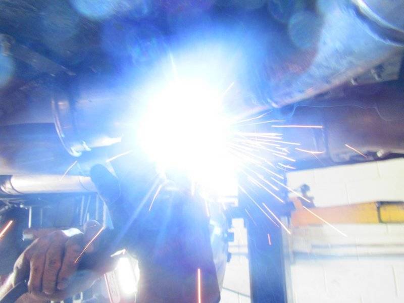

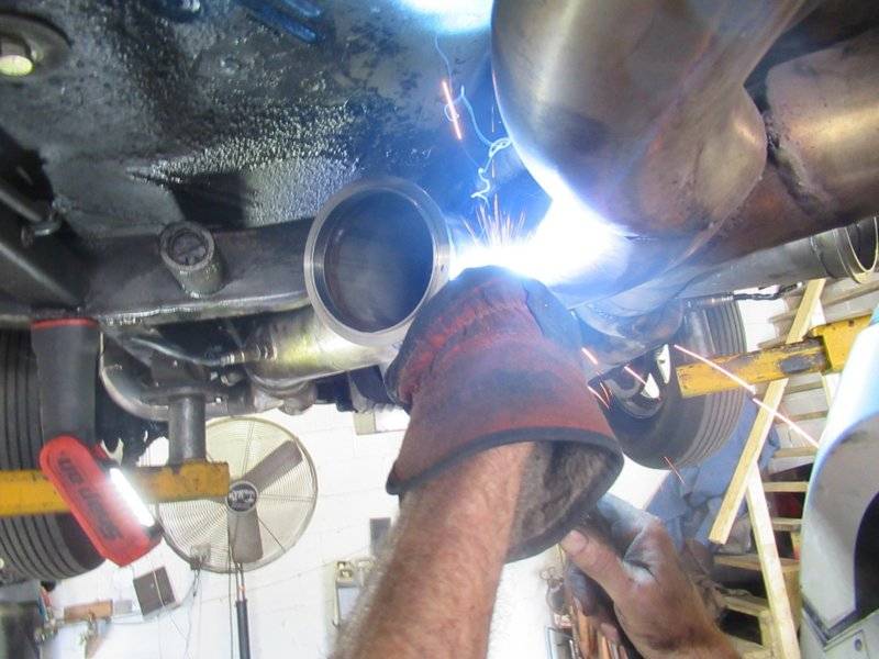

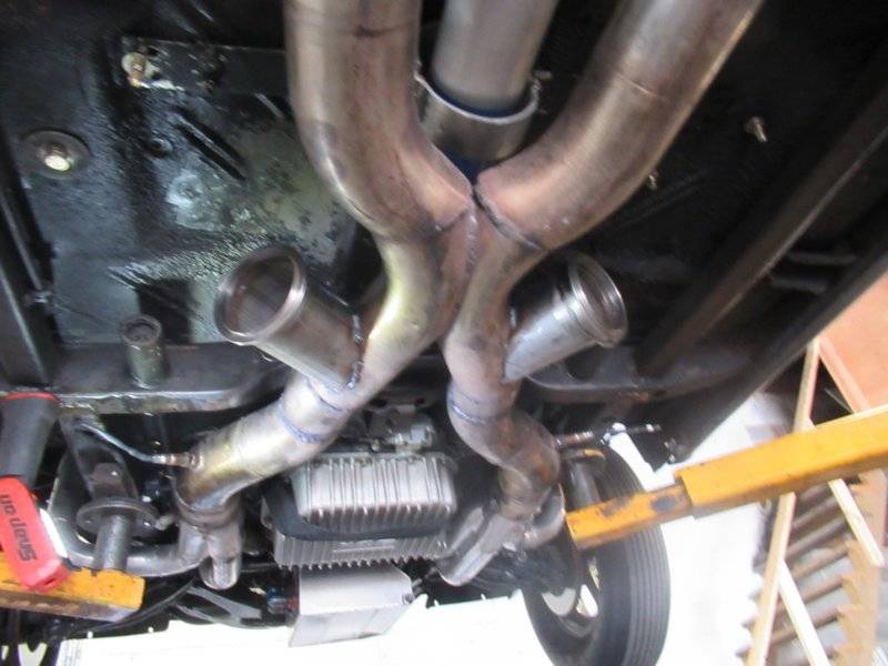

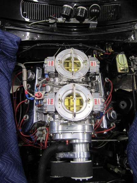

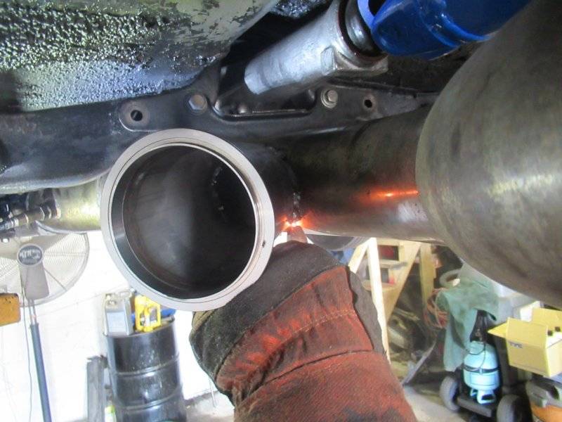

It's so hard to believe they can satisfy the demand for 116.That is the reason for my post!I can go to 13 lbs on 112 and then require 116 above 14 lbs.So I doubt I will ever need 116.My heap has been 9.3 @ a click under 147 with 6 lbs through the exhaust being CHOKED!
When I increased the boost to 10 lbs it separated one of the slip tubes in my left header.So then we put dumpers on.My fat bitch weighs 3700 with me in it.

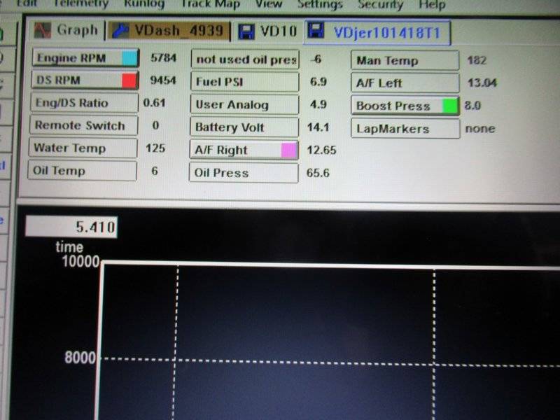

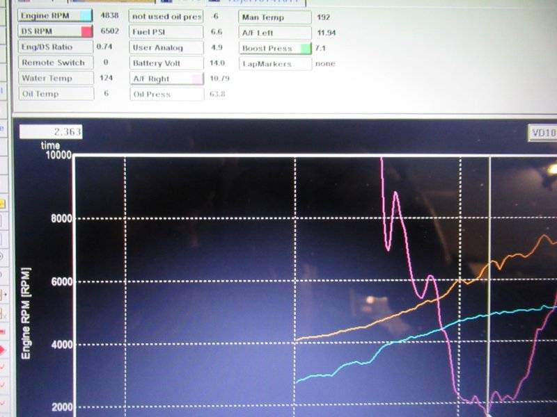

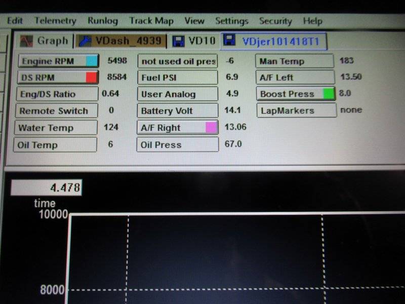

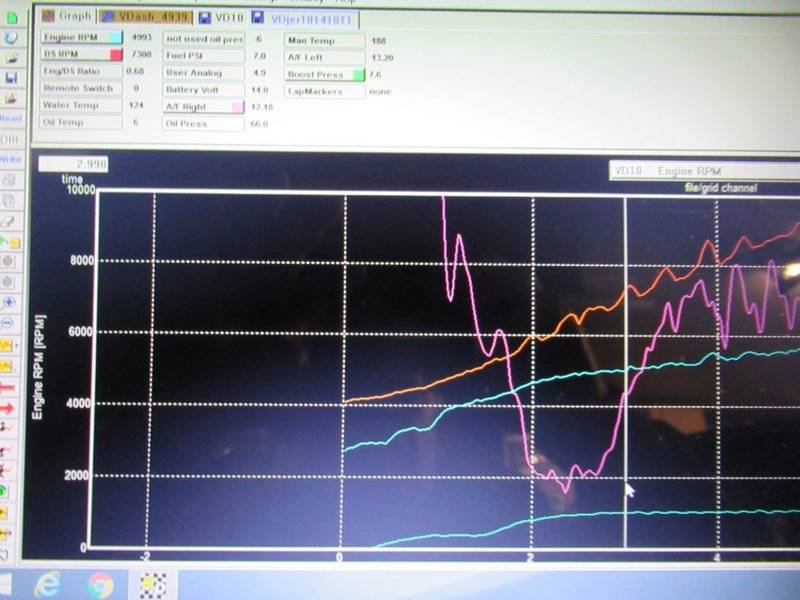

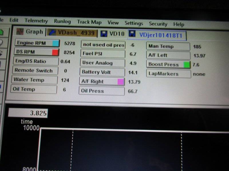

I have mixed at 7 lbs in the street,few test recordings i the street checking AFR and boost.
