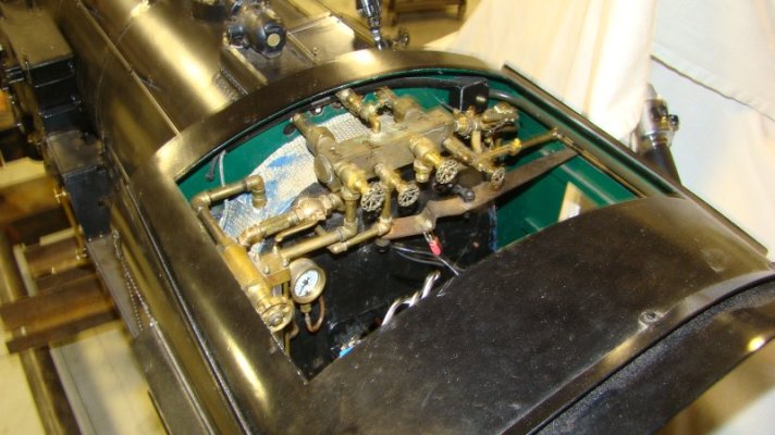

i have a couple ideas from building my steam pressure vessel days that may work.
