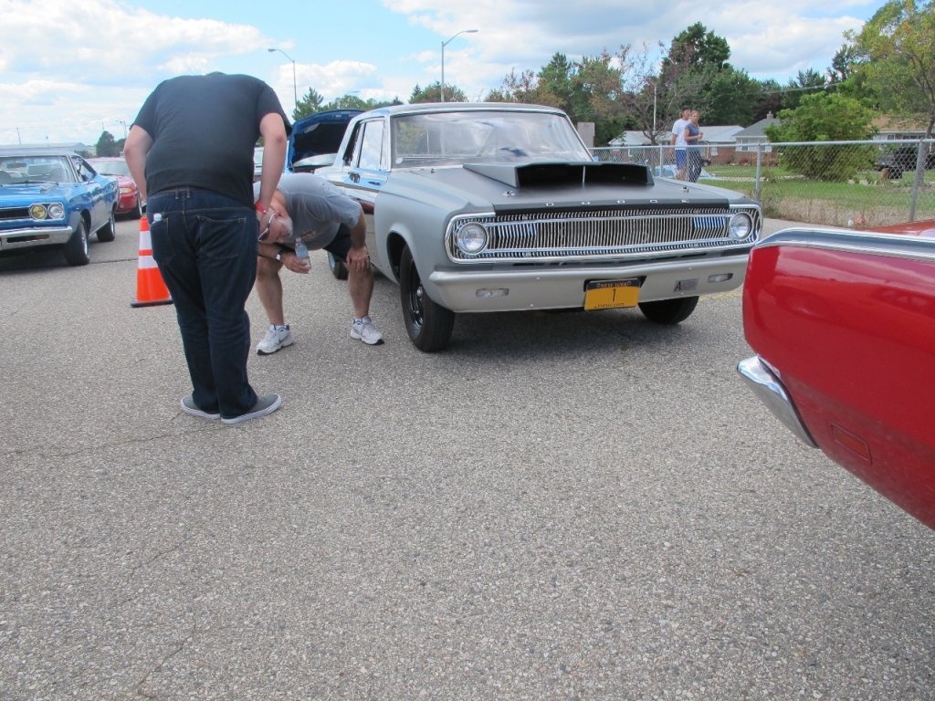

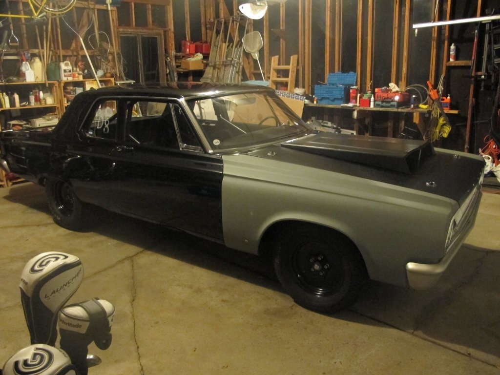

I think I'd paint the front-end.
Believe you me, I've been on the fence about the repaint for some time, but after getting an overwhelming response both here on the streets of New York and on Woodward in Detroit, I've decided to leave it as is.
I now see the logic of the look from many conversations and suggestions stating a factory experimental race car look back in 65'. After all, a host of special factory and hand fabricated parts on this pup are one of one or even rarer, one of none.

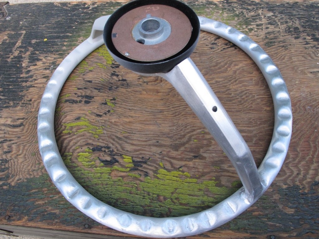

On that respect, aiming to mount the drivers seat as far back as safely and functionally possible is a good way to transfer any drivers weight more rearward. It's almost like taking dead weight out of the car by managing weight placement itself. For that reason, I hand built this slightly extended stock looking aluminum steering wheel for the 1-1/4 inch setback on the seat.View attachment 375636

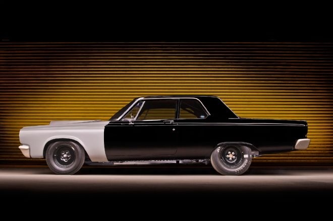

This is a Hemi-itis photo and as one can see, the rear end is an inch or so forward without too much tattle tail. Engine is almost 2 inches back in the chassis, hidden from view
. Note the AFX bubble windshield to assist in aero tactics compared to the flat stock shield on the drastically altered wheel baser in the far lane.
Last time I had it on the 4 way scales and mentioned the results on the other board, I had 3023 staring me right in the face. That's all metal/s and absolutely no Fiber glass or carbon Fiber anywhere. Stock iron block and aluminum heads. Since then I have done a few more sways of the wand and without scaling it, I'm predicting 2997 Lbs at most. With a few major tricks up the sleeves and waiting till they're finished, it will be sub 2980 Lbs for sure.

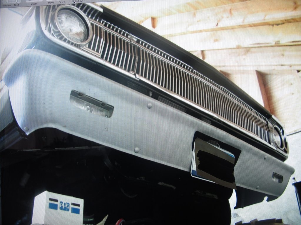

Just to keep from repeating, that front bumper you see is made out of 304 thin stainless. Weighs under 8 Lbs. Like said, there are tricks inside tricks that are beyond tricks. One just has to micro study their respective rides and go deep with their Felix the Cats magic bag.
