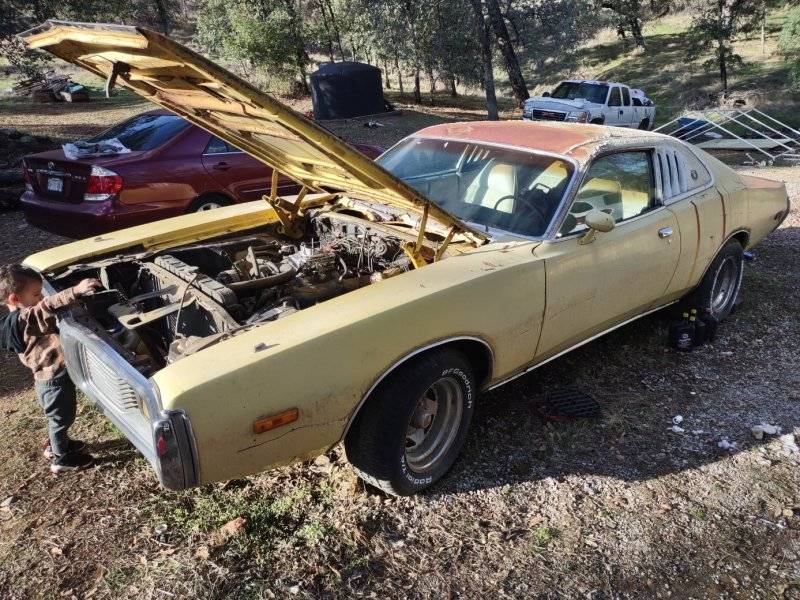

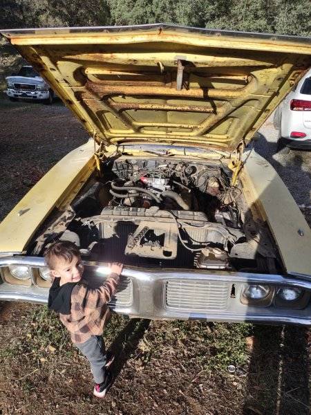

How you guys doing? I've been acquiring parts and pieces to do the headset throughout the week. So today I get to dig in! Just waiting for it to warm up a bit more before I head out there. After I get it running right, I plan to tackle the brakes, because lets be honest....there aren't any. After I'm sure it will stop, well go down the road and test her out.

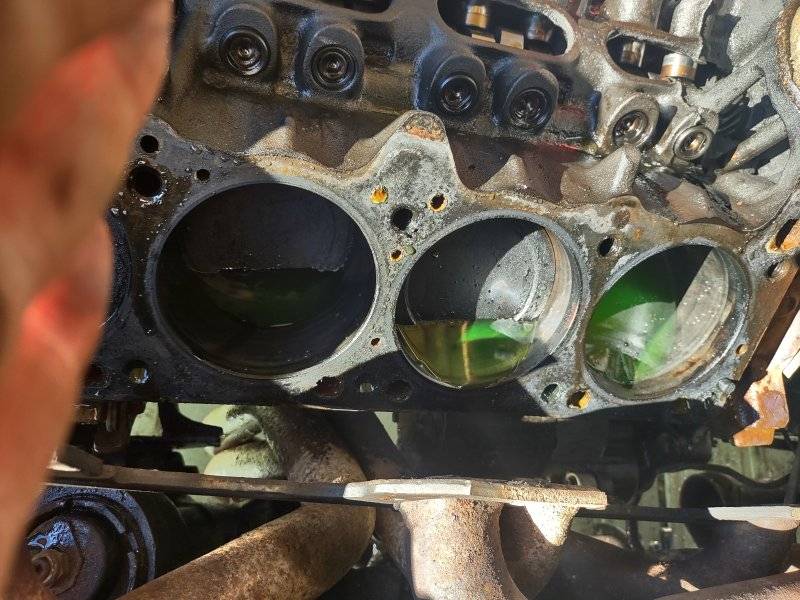

Well heads off...found a swimming pool in the cylinders. Looks like the wrong head gaskets were installed about 12 years ago. I got the right ones this round.
That happens when you remove the heads with some coolant still in them.

It looks like they had that car running on Mountain Dew! I bet she was hyper in her day!
Well I pulled the heads apart and found 1 valve stem seal that was intact. No wonder she was blowing smoke like a freight train. Unfortunately all that smoke landed in the exhaust system. So I installed new valve stem seals and all new gaskets. I am lucky enough to take another stab at the intake manifold gaskets...since it's leaking at the front and rear. I'll do that tomorrow. All in all, she woke from her slumber...uncapped headers of coarse. I used to love that...part of me still does but even just that SB360 sounds impressive. It was fun for about 15 minutes. Blew a little smoke out of the right side header due to caked on oil. Bolted the exhaust back up to it, and the freight train rolled back into town. So i have quite a bit of oil downstream too.
