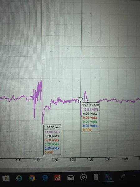

Screen shot a pass from just before going on 2 step to after finish

PS , i upped the 2step from 3500 to 4000 after first pas to see if that would help but no change
