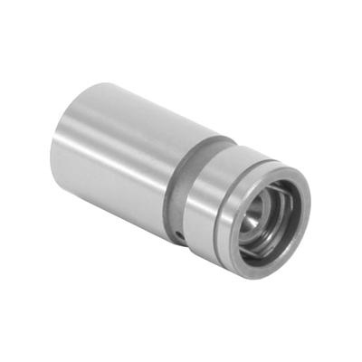

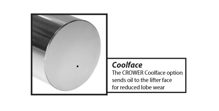

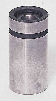

If you do elect to change your lifters, I would get a new set before measuring for preload. This is just in case the lifter cup is of a different design and potentially could wind up back at square one. I like the lifters with the edm hole in the face for additional oiling. Not sure if your current ones have that. Regardless they still need to be checked out disassembled prior installation.
