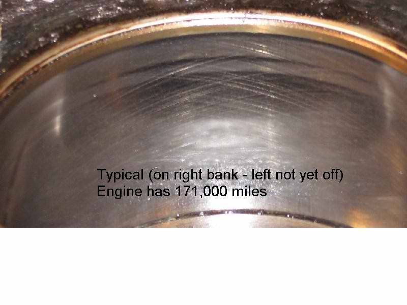

That's not necessarily a bad thing. The early Cadillac Northstars where known for "using" oil. The fact is that they had a rather aggressive hone pattern (especially if the honing stone was new), but they would never wear the rings. Here is a picture of one with 171K on it and the factory crosshatch pattern is STILL visible. That can't be bad.

Don't know what it is with 318's being driven easy or what ever but I've seen several with similar high mileage on them and the cross hatch was still visible. One was in a mid 80's pickup....

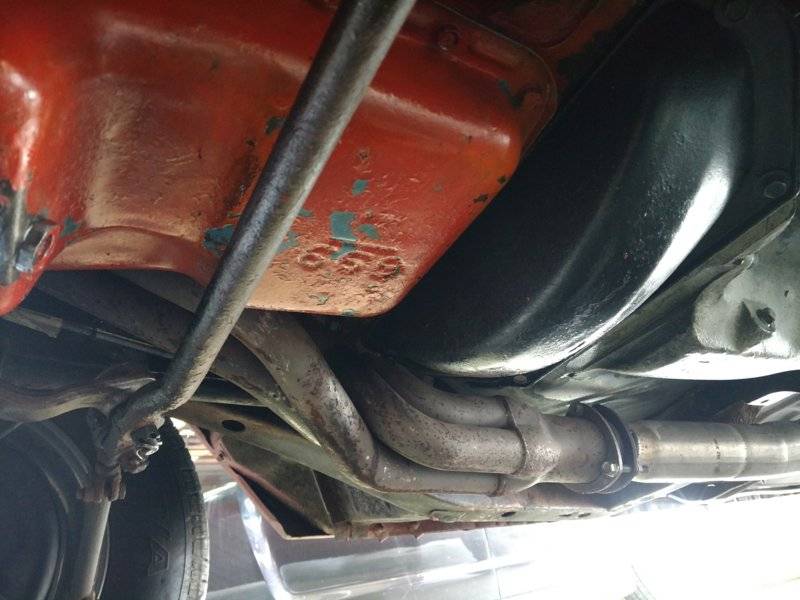

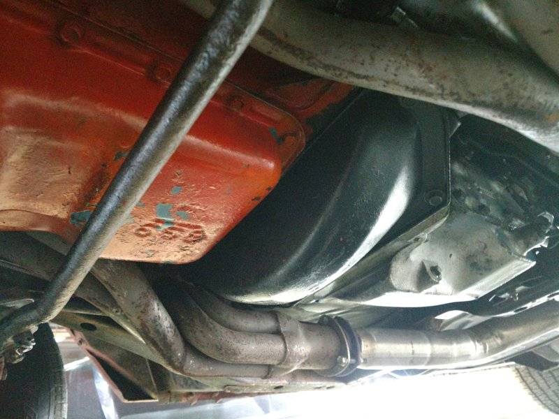

Pan says "699" on it plain as day. I read that it's the same as the vaunted 187 pan, but what does THAT mean?
I now know the 699 was used on '72-'73 c-bodies only, but that doesn't help much either.

Can anyone definitively show me what the damn capacity of this pan is SUPPOSED to be?

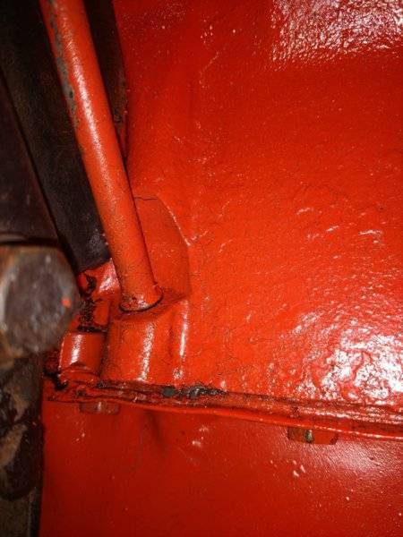

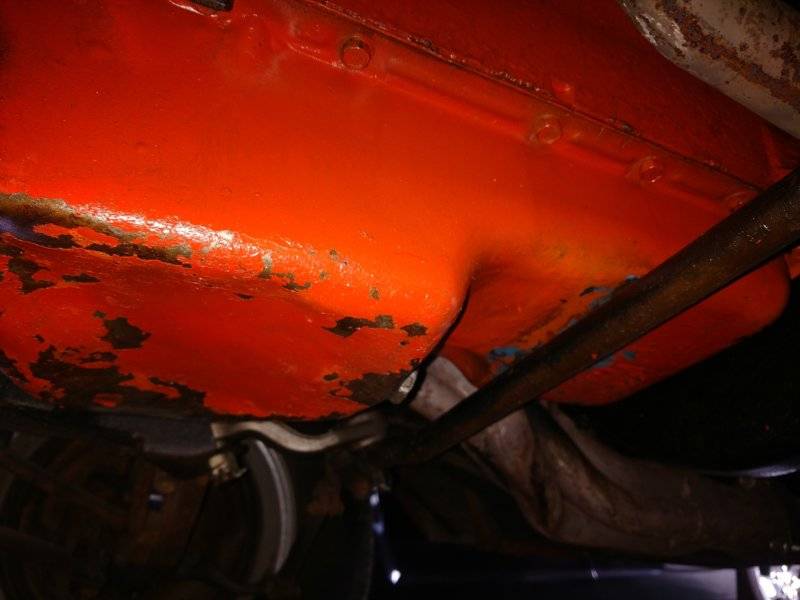

Does this thing LOOK like an "added capacity" pan to anyone?
Hell, if anything, it probably holds a little LESS than it did stock, given all the dents and such on it.

Thought I had the 187, but don’t. If it helps, I have both 402 & 695 pans. The 402 holds the mentioned 4+1 qts. Not sure on the 695, as I never used it. They are not similar in appearance to your 699, in that there is no recessed area for drag link clearance as depicted in your photo. However, with that being said, the 402 is original for my 69 383 (believed also for 440, 426 & later 400). The 695 was supposedly a NOS for 383/440 obtained in 1973. If needed, I will send u photos & sump measurements...and also those of the original dipstick & tube.....Jim
