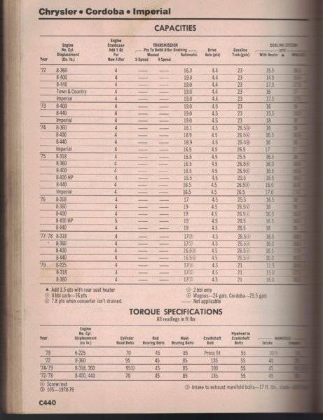

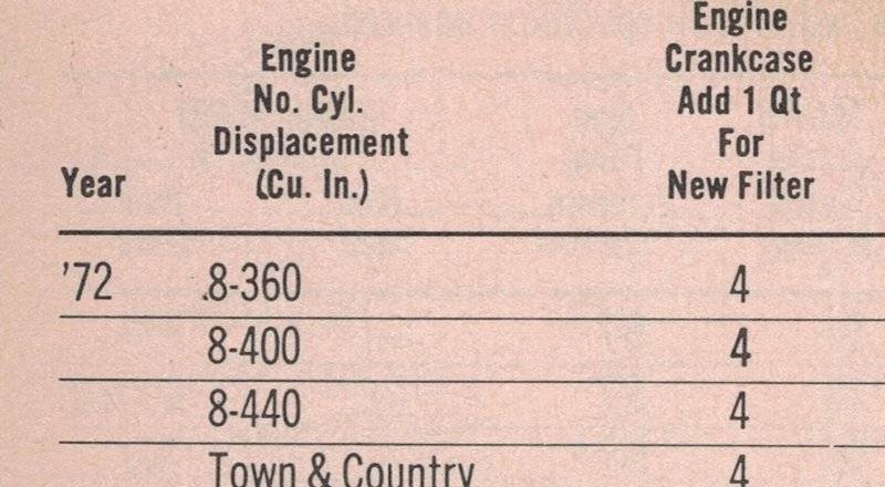

Went digging through my old books in the garage and EUREKA!
Good enough for me. Off to the garage.... :thumbsup:

I can't believe I forgot I had all those old manuals in the shop. A friggin Chiltons (ugh!) saves the day.

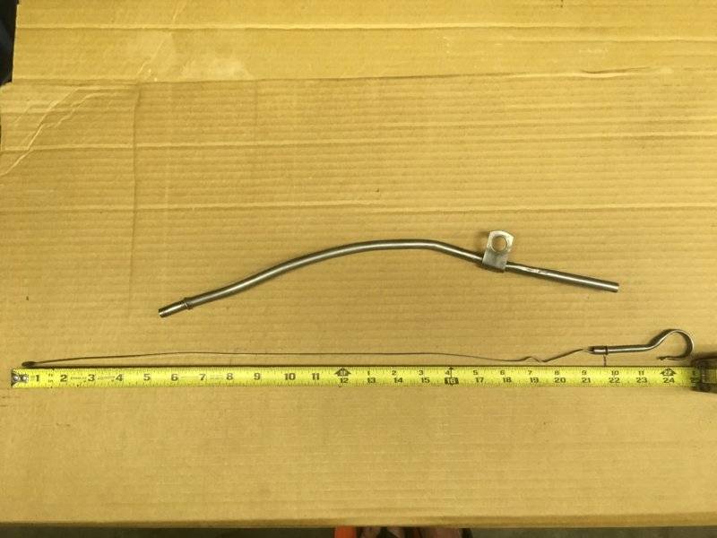

Ok, in addition to all my other questions, I need to ask someone a favor here:
Pull your dipstick and measure it from the little flange seat that stops it in the tube up top down to the very tip
at the other end, please?
I think we're about to find something out here. :)
If this is what your needing it’s 21 3/4”s.......however, mine is original to a 383, unknown if the same as a 440....
Thanks!
Yep, that's what I'm after - and that's making me nervous again.
The one I have, which is obviously an aftermarket one of some sort and chrome, is the same length as yours is.

Yep, total of 5 in there with filter. Stick appears to be the correct length.
My aftermarket and the one in my 361 measures 22 1/2" from the grommet to the tip. But the marks are different between the two when side by side.
