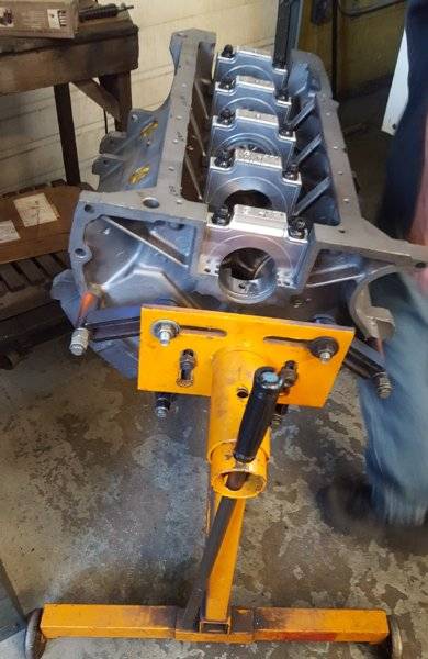

Finaly got car out of the panel shop and into my shop yesterday .
Time to locate the internal coolant leak .
Motor and trans out last night . Pulled the heads and pan today .
Was crossing fingers it was a bore issue . No such luck .
Cracked #4 web from the cap to water jacket . Cracked along stud thread area .
Lucky as i did put 6 or 8 passes after it showed moisture , and found split head as well . Changed them last month .
Back to old 440 for rest of year .
Damn i need a new cross bolted block , no point doing the same again and risk driving over the crank .
Dont want aluminium just an iron block
Tex

have you considered using Alum caps on the iron block?
I thought I would be ok . Only 11.0:1 comp , conservative tune and only 6000 shift
4.25 stroke with billet steel caps and studs .
Ended up around 680FWHP .
oh well that's racing
Tex
sonic check wont tell about the web .
I have run this block since Jan 2017
Just bad luck
Tex
Been down this trail as well. But I didnt find it in time. Broke the crank in half when the front 2 main webs pulled out of the block. It's not if a block will break at this power level, it's when. Some will go for years. Personally at your power level a 400 block wouldn't scare me.
Doug
rule of thump- iron block- Alum main caps.
Alum block Steel caps, this works with fuel engines.

Doug, I think we all have been down that road a few times with broken engine parts. I agree with your thoughts about "when", kinda like riding a motorcycle, it ain't "if you put one down, it's when". I always keep a spare standard bore block under the work bench.
Bob :moparsmiley:

Glass half full Doug - I didn't drive over the crank .
All my stuff is RB - plus there are not a huge range of blocks floating around here . I will persevere with my old short block 440 . I do have another 440 block but really if I could access a mega/world block I would be on it like flies on sheep **** .
Old short motor now has the TF270 top end and racing hopefully tomorrow
Tex
