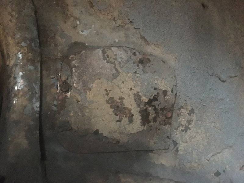

Not the greatest picture I know. What’s the genuine purpose of the little square access doors held by 2 screws on the inner front fenders ? Im sure to allow access servicing something. I know some Mopar fanatic is going to take this personal. But, It seems pointless and worthless. Unless, I’m missing something ?
Oh nothing personal. Yes you are missing something.
It is for accessing the eccentric nuts when doing a front end alignment. Look on the rear side of the shock tower, see the rubber flaps that come off, allows access to the rear nuts. This way the alignment can be done from under the car. They had these procedures down to minimal time on assembly line.

You answered your own question:)

.... and depending on how much of a kerfuffle changing your rear spark plugs is (with certain headers), they can be helpful for that too.

Thanks a lot,lol. Need to buy replacements for my car; took them off to save weight,accessibility when racing years ago!

pearljam724, remove your rear splash shields to access the dog leg area for pin type emblems. Also oldbee, I have a very nicely restored original pair of those inner fender inspection plates w/screws for 66-70 b bodies. Start a conversation. Thanks
Don't know if your car has access to inner fenders like my '63 does. There are cover plates bolted in the fender wells you can remove to get behind the fender to access the emblems and the antenna.
