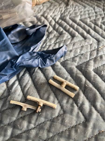

I need to replace this door window pieces but don’t know the name of them. Anyone know the name and where I can purchase them from?
They are for the division run channels. Best if you can find some originals because the repops are to big.
Would you happen to know the proper name so that I can surf the web originals or repost if I can find originals? And thanks
They attach the front vent window channel. Called what????

Mopar A Body 67-72 & B Body 68-70 Door Glass Division Channel Guide Set 2932230

Actually, I just replaced my runners from DMT, the repops that came actually looked a little smaller than original. My originals are in good shape. I'm just going to reuse the originals. Yours look to be in pretty good shape Cyty. I would just re-use them if they are. Make sure it's a pretty tight press fit and you should be fine.
I just read all the posts. If you're bent on replacing them I'll just mail you the set out of my kit if you want.
Ok. Thanks
That's good to know. I wasn't even thinking about the latest version. I had several sets of the last run of crappy repops and those were all to big.
That's good to know. I wasn't even thinking about the latest version and haven't had my hands on any. I had several sets of the last run of crappy repops and those were all to big.
