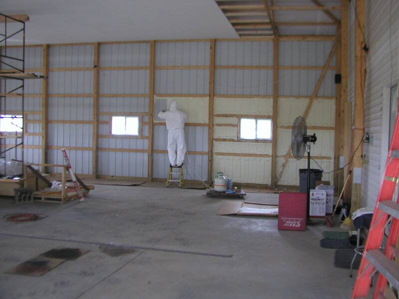

Spray foamed the inside to seal up and stop all wind penetration and drafts. This added about an R7 insulation value to the walls.

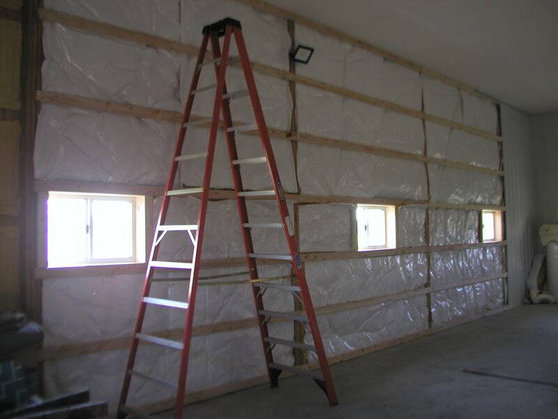

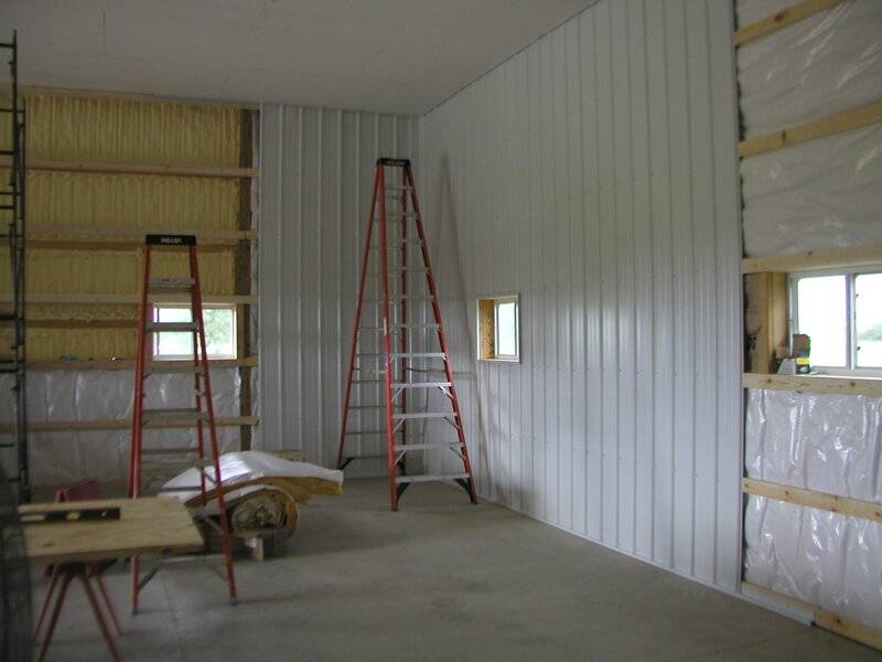

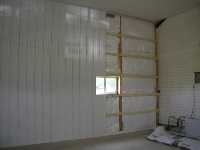

For most of June and up through today, I've been further insulating the walls and installing the finish metal panel walls. Using 4' and 5' wide fiberglass rolls to fill the wall cavities with an additional R19 of insulation then covering with the 5 rib steel panels. Walls will now have an R value of about R26 or so.
