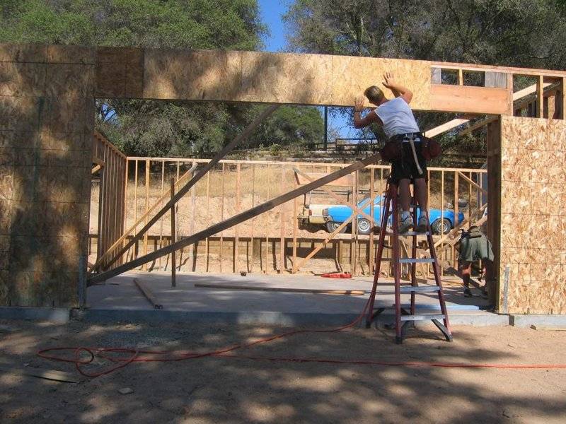

Here is my shop I built in 2006:
View attachment 660588 View attachment 660589 View attachment 660590
