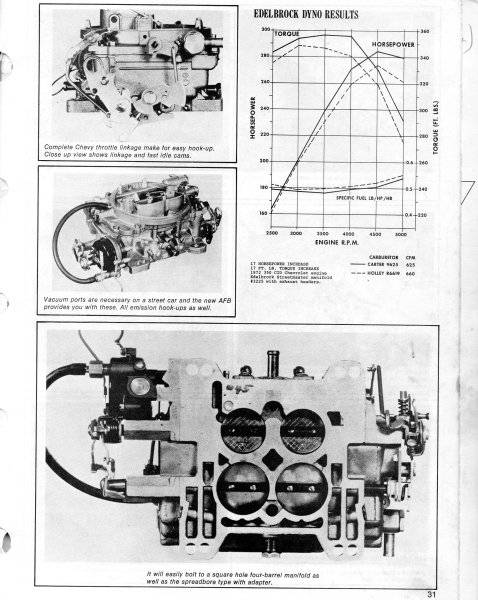

Ah, yes the Holley vac carb. Didn't do to well against a 625 AFB [ see below ]. Made less tq, less hp & used more fuel....
Over on FABO, you will see a thread where a Poly Stroker engine had a 600 vac sec Holley removed & replaced with a Edel AVS2. When the owner went for a test drive with the AVS & went to WOT, he thought the trans had kicked down to 2nd such was the acceleration improvement. But no, still in high gear....The smelly was also gone....
