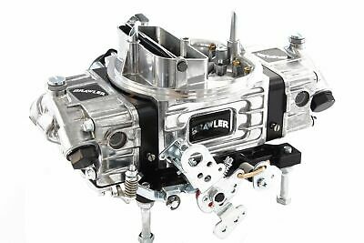

I prefer The Holleys because many of the tuning difficulties have been solved. In other words, I have a new 750 Brawler vac sec. On my 383. The jets can be changed from the top and the secondary Spring adjustment is a screw now, both floats bowls have a sightglass and center inlets. No more taking bowls off! Other than slightly less power off line, on a hard jab to the throttle, it winds excellent to 6000
