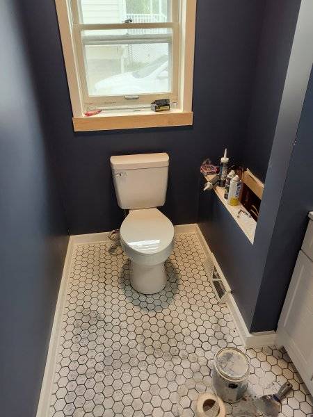

Work has been killing me so this is the first I've been able to make any progress in a couple weeks, but...floor tile is in and grouted (still needs cleaned), vanity is installed, baseboard is in, sealed, and painted, new toilet flange installed (75 year old black iron flange was...sketchy), toilet is set, stable, hooked to water (no leaks), and test flushed a dozen or so times (just water) with no leaks on that side either above or below the floor. I'll probably keep testing it before I seal the base to the floor, just to be safe.
Now, to tile the tub surround...
