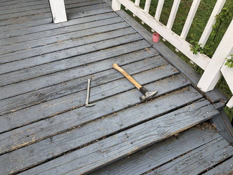

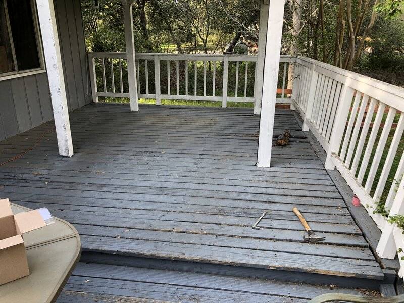

Since I have SO much money, I decided to jump in and do THIS:
This section of the deck was looking shabby.

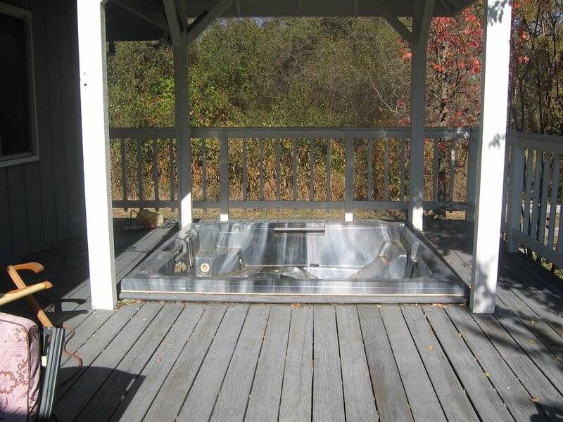

When we bought the place in 2004, there was a hot tub there:
The heater didn't work but the bubbles did!

Since I pulled the hot tub and RE-decked it, it was fine up until about 2 years ago. I never built a deck before then so I just used what I had...Galvanized 16D nails to fasten the deck boards. Nowadays it seems that everyone uses screws. The nails were popping up in a few areas which meant that the structure was flexing and allowing the nails to move around.

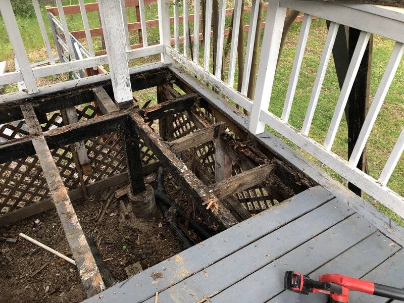

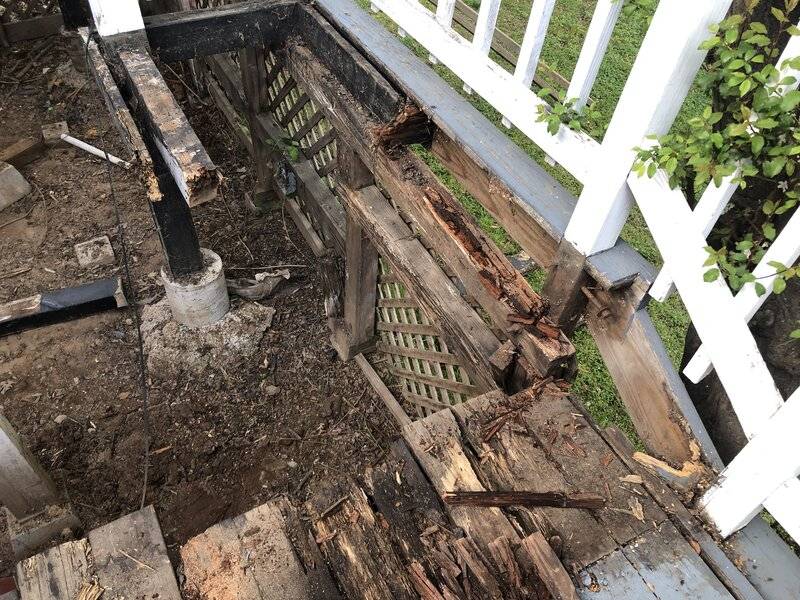

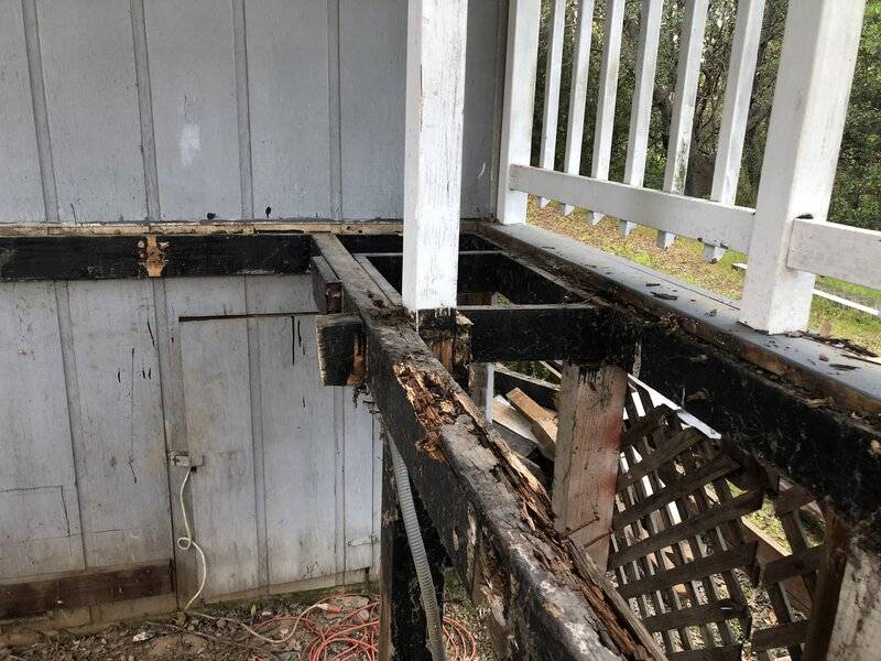

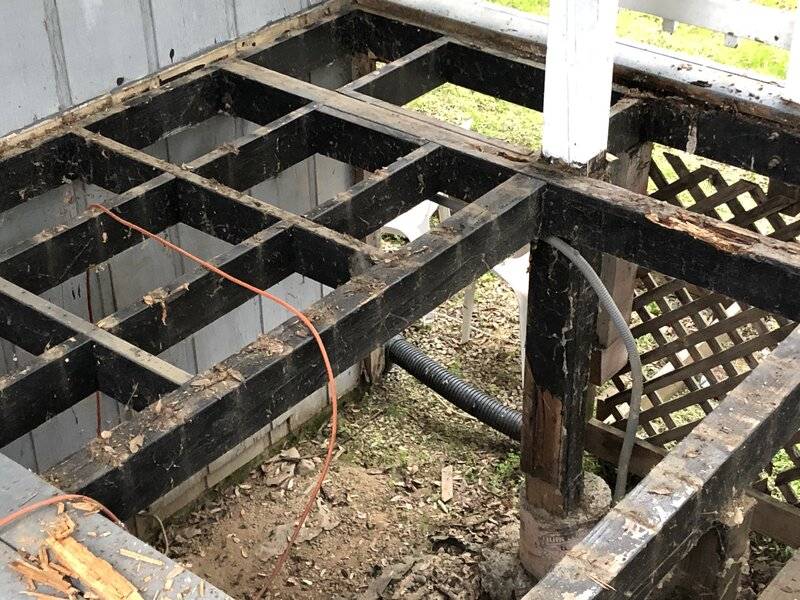

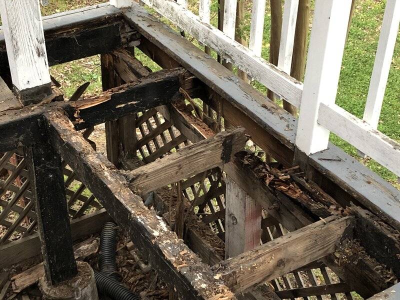

The supports were fine in 2006 when I redecked it but they rotted away since then.
This was a huge surprise. I don't know what was keeping it from collapsing.
I decided to gut the entire thing and reframe it.
This section was 16" higher than the main deck. I'm going to build it to the same height as the other so it is even all the way across.

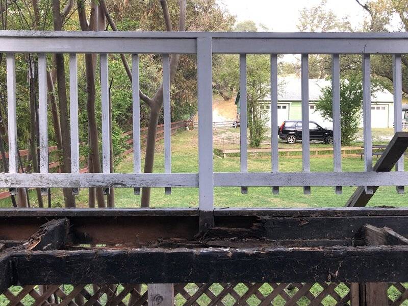

I've been working jobs the past few years that sometimes involve remodeling. This often includes reusing stuff that might otherwise get thrown away. This means being more careful on disassembly.
The railing between the posts will be reused...

It is funny...This project is like a classic car that has a few bubbles showing under the paint. The more you dig in, the more rust you find.
Also, to a person that has no experience with this stuff, it looks really intimidating. They might wonder how the hell am I going to get this thing built back right?
To me, this is fun.

Do you guys get treated timber? That looks like plain timber to me. Treated stuff should have lasted way beyond what you got there.
Or do you just rely on paint systems to preserve the wood?
I just returned from the local gas station....spent $200 today. Prices have come back a little bit....and there was a decent discount this weekend. :rolleyes:
Oh, yeah....we use pressure treated on the bottom plates of wall frames. Some do use it on deck framing as well.
This deck is mostly Douglas Fir on top and underneath and this section is the only one that rotted this bad. That is because it is right under the edges of that patio cover. Leaves and other tree debris get in between the boards.... The rain sheds right off and lays on the deck there. It is just like where dirt gets trapped in a metal seam. Add in moisture and eventually, it rusts out.
Under the roof covered areas, the deck 2 x 6s and framing was still nice even with dog hair and other stuff getting in between the boards. The rain water sitting in between is the killer.
The rest of the deck is about 60/40 covered/open.
Always use pressure treated, always.
Some also use redwood for the deck boards but HO-LEE crap! Have you seen the prices?
Last Summer I spent $140 for THREE 2 x 6 x 12s!
Always use pressure treated, redwood, cedar, none of it will out last pressure treated. I've built and rebuilt over a hundred decks in my life time. Mine at my old lake house was a two story deck 30 feet above the lake, all treated. I would roll a sealer on the deck boards every other year. It's still looks very good after 20 years. The deck boards on my boat dock needed rolling every year from the sun and water. Took an hour to roll my dock.
