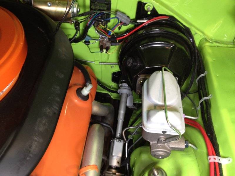

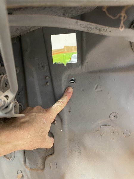

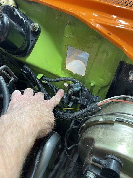

Guys looking through my docs but I can’t find what this hole in the firewall is for. From my engine bay picture there is a bolt in there and also another just like 7 inches away laterally.
Be a lot easier to identify if we knew what year car...if it's a 70 4-speed, could be for clutch pedal/ neutral safety switch. Hard to tell in pic
Its my 1970 Satellite which is automatic. There is a stud that comes through from the interior and a nut from the engine bay and like i said previously there are two holes.
I have a 1970 Road Runner with a 4 speed. As stated above, that is where the neutral safety switch wire comes out.

Still wondering about this hole. My old pictures show bolts coming out into the fire wall.

On my ‘69, that hole is for the left side heater box stud mount……
Thanks makes sense since I am not mounting the box and have some extra holes.
In some cases, the firewalls were punched with holes to accommodate some things that didn't come on every car. One example is the clutch linkage pushrod. In automatic equipped cars, they just plugged the hole with a plastic plug. The same could be true for the hole you're asking of, Ron.
