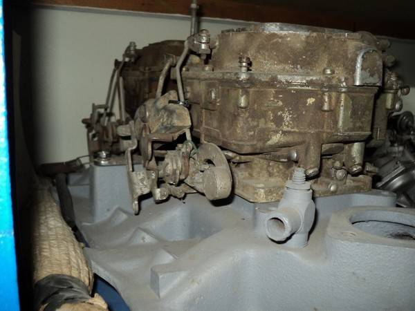

A friend of mine has an old iron 2X4 BBL Poly Intake sitting on the shelf ! WITH the original Carbs !
I told him once before "that must be rare as hen's teeth" ?
Because, I didn't even know they made one before that point in time ?
How does a guy post Pictures on here... I took a photo of it awhile back for shits & giggles.

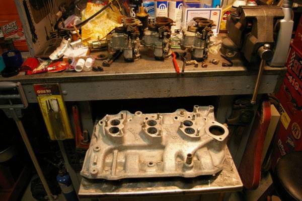

what do you guys plan to do with all these cool parts? To me they are like memorabilia. Is that fair to say?
I think it's fair to call it that. Of course these parts can still be used if one decides to. The 3X2 intake and the carbs on the bench (I posted above) are bolted together and hanging in the shop. For me to see something like that is like a flash to the past when the parts were new and the guys back then were souping up their engines. Sometimes I refer to it a "garage art".
