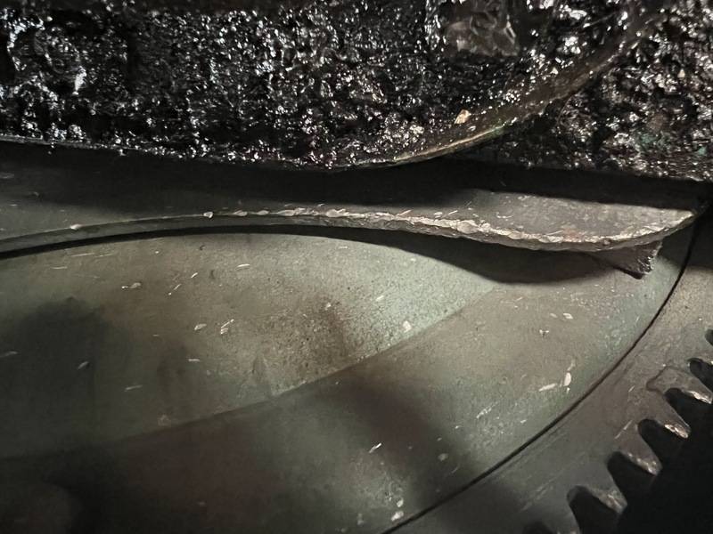

Not a lifter....too fast at idle. Sounds like all the flex plate bolts hitting. Check the inspection cover.
It does look like the flexplate is hitting something.
I put some sharpie on it to make sure the damage is fresh, and it is.

All the bolts seem to be snug. What else is there?
Also, I had to add a quart of ATF as it was low.
