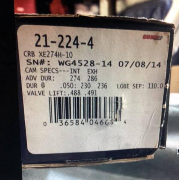

I have a 67 Coronet and im looking to get higher stall converter but im not sure what rpm to get or what brands to look at or stay away from. Car is street driven but I plan on taking it to the strip.
Specs - 440 .30 over
- aluminum 440 source cylinder heads
- performer rpm intake, holley 750 dp
- 10.5 to 1
-727 trans
-3.73 rear end with an auburn sure grip
-275-60-15 rear tire
Heres a picture of the cam specs
Thanks -thequickster
Found this on Summit that's the exact same grind as this Comp XE cam.
COMP Cams 21-224-4 camshaft recommends the use of a torque converter with a stall speed of 2,200 or higher.
- 10.5 to 1
-727 trans
